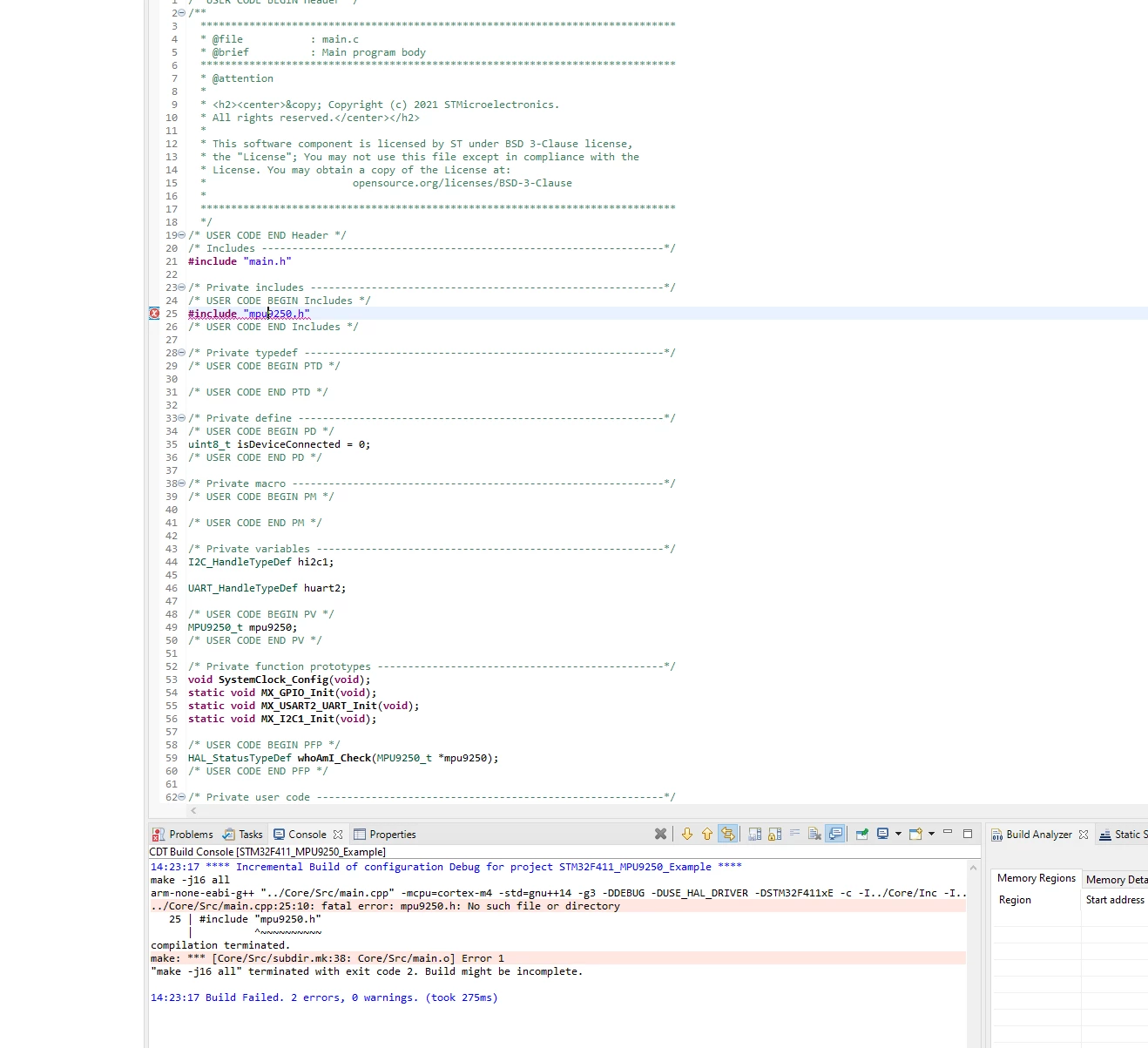

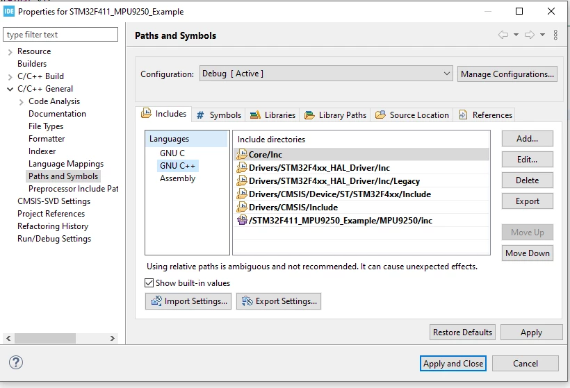

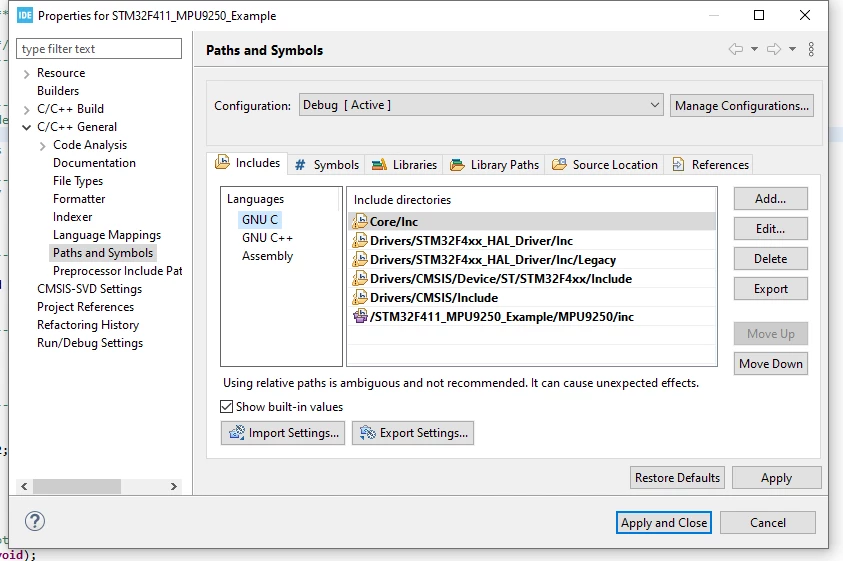

STM32 Includes = stm32_includes.png (Note the same path is linked to C++ as well)

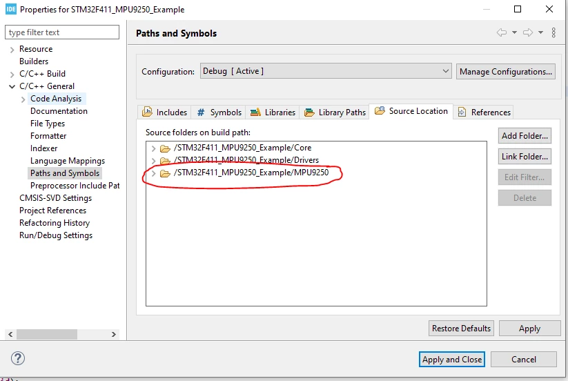

You're compiling a C++ file, but the includes that are shown are for C files. There is a different tab for C++ includes.

Sorry, I shouldv'e been clearer in my initial question. I linked it for both C and C++ just in case I needed them both.

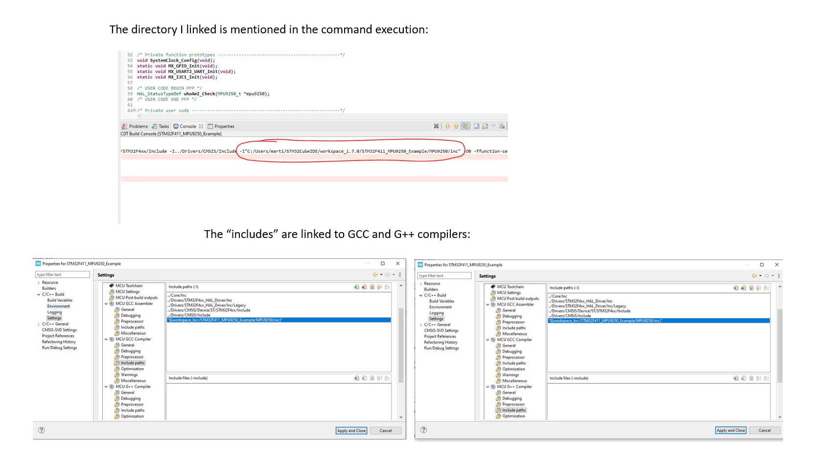

Are these same directories also listed in C/C++ Build -> Tool Settings -> MCU GCC(and G++) Compiler -> Include paths?
The actual compile command shown in the console used to compile should also show what include directories were used to compile.

Hi TDK,
I tried to find out the bits of info you mentioned, they're in the attached image (only one upload allowed I think).
