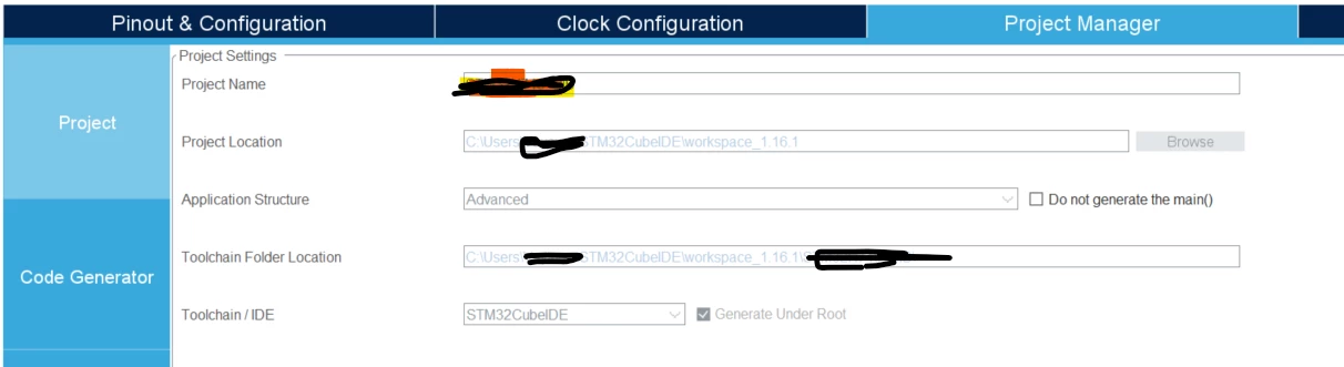

Hello Team,
I wanted to generate the code through the STM32CubeIDE and use the Keil simulator to test the code.
I have gone through this pdf  https://www.keil.com/appnotes/files/apnt_323.pdf,
But when I try to do this same thing with the STM32H743BIT6 controller, I am not able to change the Toolchain.
Could you please help me with this?

you have to use the stand-alone STM32CubeMX if you need to create code for other toolchains than CubeIDE.
Hope that helps?
