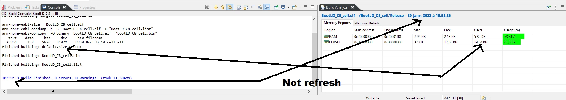

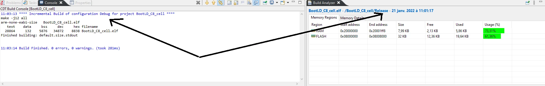

Seems the "Build Analyser" view is not well refreshed sometimes (that's why I was confused in the first place)0693W00000JMp99QAD.png0693W00000JMp8uQAD.pngIf I rebuild, the Build Analyser data doesn't update. Sometimes it works sometimes not. Havent figured out yet what could be the root cause
