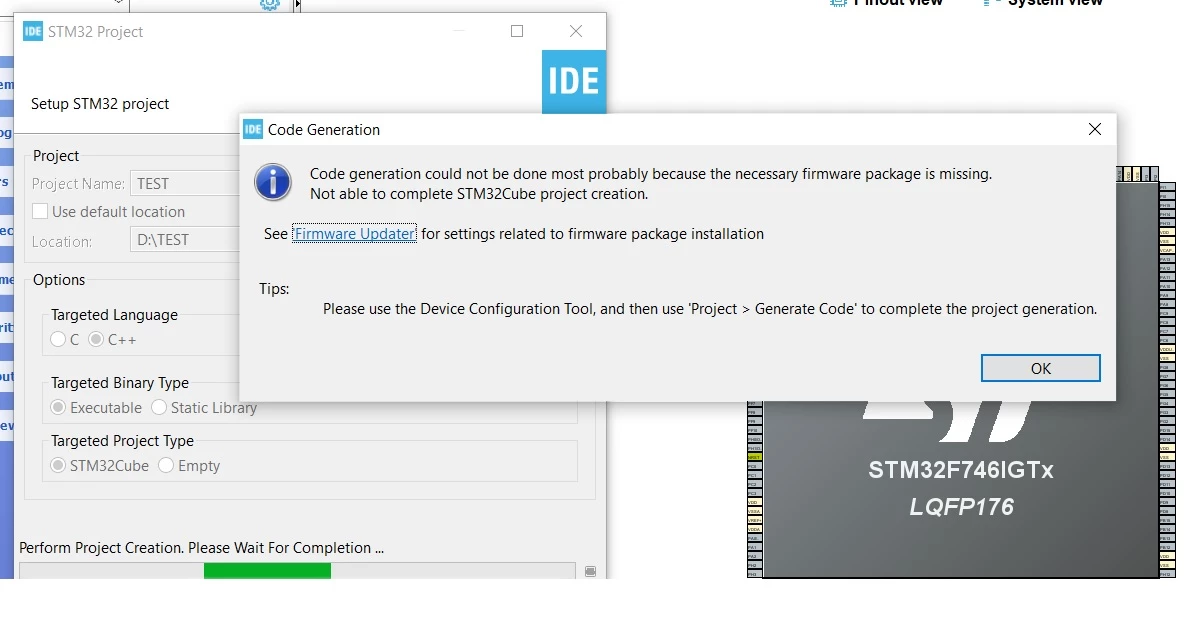

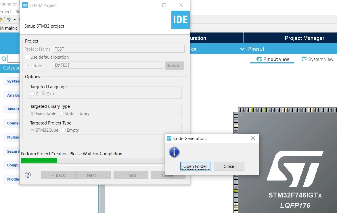

STM32CubeIDE Version: 1.6.0 would not generate code for a new project for any uC series (but will update code for existing projects)

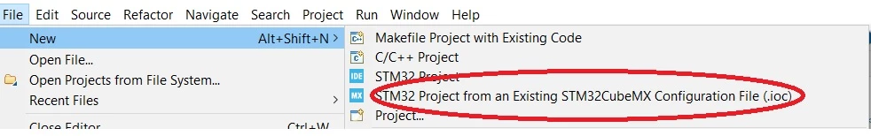

I encountered this problem after trying to create a project from an existing ioc file. Afterwards all my endeavors failed as per the below screenshots:0693W000008yEOnQAM.jpg0693W000008yEOsQAM.jpg0693W000008yEP7QAM.jpg0693W000008yEPHQA2.jpg0693W000008yEPRQA2.jpg

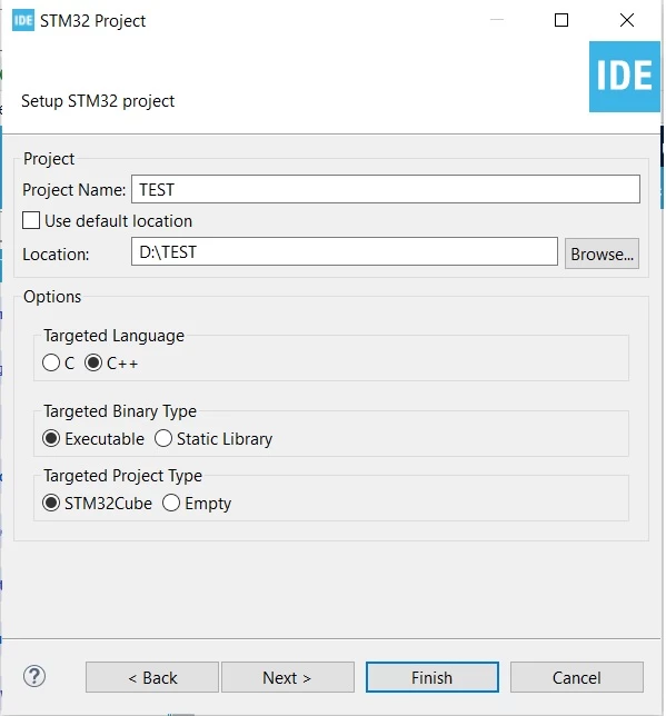

I think bug is really about project folder location support if only a single folder on top of disk drive root.
On my side I've got a try (and same issue so) based on File > New > STM32Project.
I guess bug is about unchecking 'use default location' and setting destination folder so close to disk drive root. If keeping default project location is at min 2 level deep within file system hierarchy because first workspace then project repository like : <disk drive root>/<workspace repository>/<project repository>

On latest dialog popup what about if clicking ok then ask for code generation back relying on dedicated toolbar icon (gear weel) ? Is project generating fine then ...

The IDE will crash and I had to kill it.

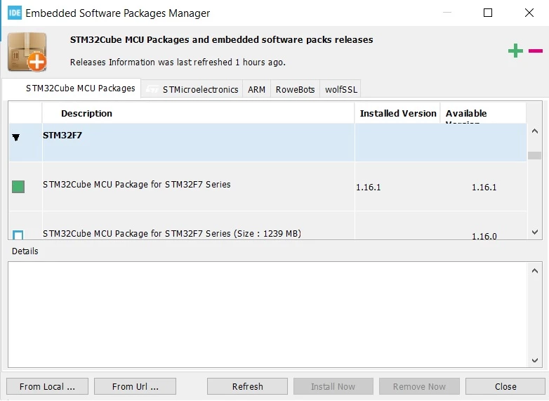

I've tried to uninstall/redownload the IDE. Still I've the problem. Apparently the uninstall does not provide a clean slate as the installed packages in the old installation are still alive and well, e.g. TouchGFX. Can you please advise how can I really get a fresh start so that I can resume my project.

I've been able to reproduce following your snapshots.
Have a try to set as project location D:\myWorkArea\TEST ... works for me ... sounds a bug here using non default location having only one level hierarchy on top of drive root. Adding extra level is solving trouble.
Have a try and share if helping

ksale.1Author
Senior II
Mar 30, 2021 8:25 PM UTC
Thank you very much, it is working for me now as you advised.
