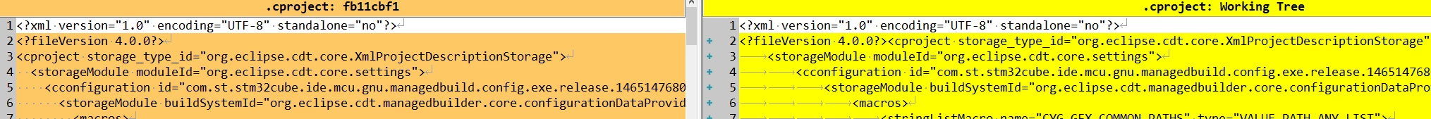

    I also observe Cube 1.16.1 to be generating inconsistent outputs - in my case .cproject file. As if different generators are used/installed.
    In a commit on the left, rows 2 and 3 are on separate lines but in newly generated .cproject these are combined into single line 2 on the right. Also spaces are replaced with tabs.
    ferro
    Lead
    October 31, 2024
    This is caused by .cproject being altered by Cube(indentation with tabs) vs GfxDesigner(indentation with spaces). Impressive.
