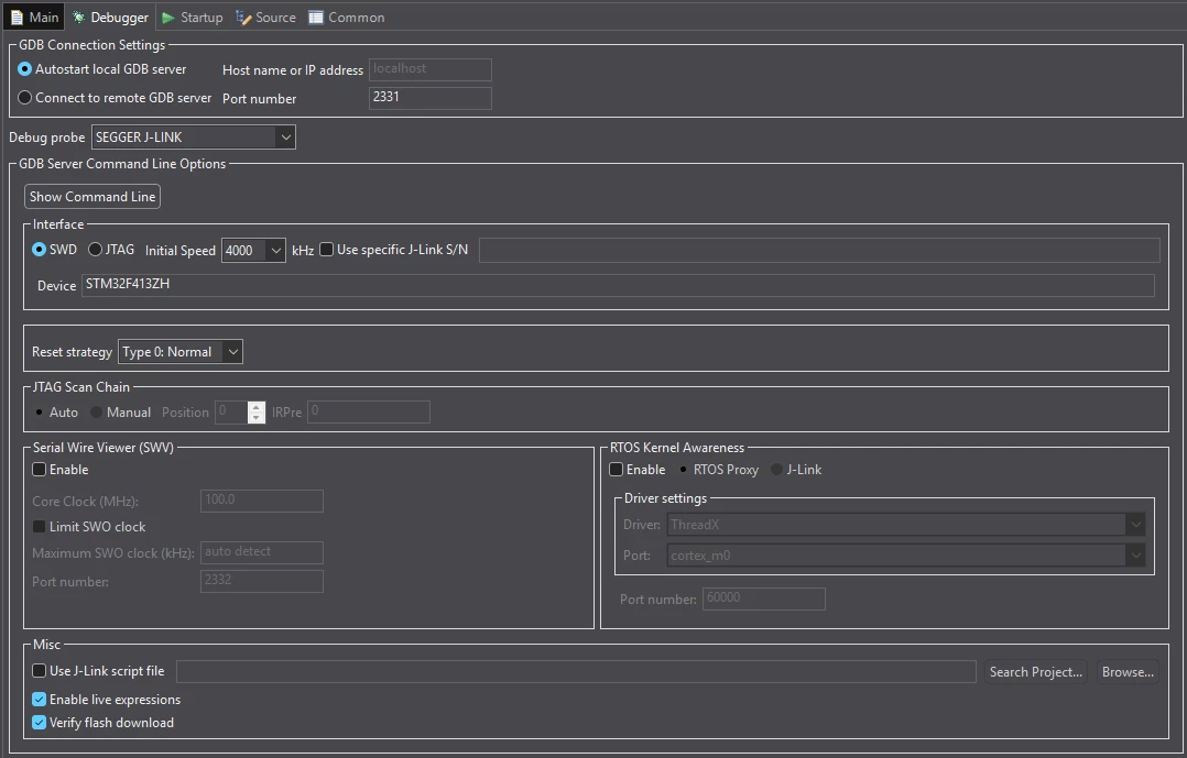

STM32CubeIDE v2.2.0 : target doesn't run after programming using J-Link, requires reset
Since updating to STM32CubeIDE v2.2.0 (and on a fresh install of v2.2.0), when I program my target STM32 (F413ZH) using a Segger J-Link, the code does not run until I power cycle the target. I’m fairly certain this issue coincided with me switching from CubeIDE 2.1.1 to 2.2.0.
I have tried all 3 reset methods in the Debugger settings (Normal, Core, ResetPin), and they all exhibit the same issue. With ResetPin selected, a scope capture of the NRST line shows it asserting only once at the beginning of programming.
I also tried STM32CubeProgrammer, with the J-Link dll update to v9.56, and it does work when the “Run after programming” box checked.
As far as I can remember I didn’t change anything in the Run configuration when switching from 2.1.1 to 2.2.0.  The GBD console log (below) shows “Starting target CPU...” and then right after “Debugger requested to halt target...Target halted” and then it is never resumed or started again. Additionally, I believe the GDB console in v2.1.1 had more at the end, like “Shutting down...” or something. It’s not clear from the log whether or not GDB is correctly releasing or closing, but based on what I’m seeing, it doesn’t seem like it is.
Has anyone encountered this problem, and have any suggestions on a fix? I would like the code to run on the target after programming without needing a power cycle. Let me know if any additional information is needed.
Run configuration Debugger settings:

4 replies
MGogr.1
Senior
Jul 16, 2026 4:08 AM UTC
Revert to old version 2.1.1
DazaiAuthor
Jul 16, 2026 6:07 PM UTC
This issue does seem to be a bug in CubeIDE v2.2.0.  I reinstalled v2.1.1 and it started the code after programming.  The last two lines in this output from the v2.1.1 GDB console is missing in the v2.2.0 output, so I suspect v2.2.0 is not restoring the target state and releasing the J-Link connection:

Downloading 51764 bytes @ address 0x0801F7D0 - Verified OK
Downloading 28444 bytes @ address 0x0802C204 - Verified OK
Downloading 8 bytes @ address 0x08033120 - Verified OK
Downloading 4 bytes @ address 0x08033128 - Verified OK
Downloading 4 bytes @ address 0x0803312C - Verified OK
Downloading 55876 bytes @ address 0x08033130 - Verified OK
Downloading 64 bytes @ address 0x0815FFC0 - Verified OK
Downloading 252 bytes @ address 0x08160000 - Verified OK
Writing register 'pc' = 0x08013764
GDB closed TCP/IP connection (Socket 984)
...Target halted (PC = 0x0000000008011B0A)
Reading common registers:
Reading register 'r0' from hardware = 0x00000009
Reading register 'r1' from hardware = 0x40000000
Reading register 'r2' from hardware = 0x00000000
Reading register 'r3' from hardware = 0x2000E3FC
Reading register 'r4' from hardware = 0x0000000B
Reading register 'r5' from hardware = 0x0000000C
Reading register 'r6' from hardware = 0x00000000
Reading register 'r7' from hardware = 0x00000000
Reading register 'r8' from hardware = 0x00000000
Reading register 'r9' from hardware = 0x00000000
Reading register 'r10' from hardware = 0x00000000
Reading register 'r11' from hardware = 0x00000000
Reading register 'r12' from hardware = 0xFFFFFFFD
Reading register 'sp' from hardware = 0x2004FFD8
Reading register 'lr' from hardware = 0x080138FB
Reading register 'pc' from hardware = 0x08011B0A
Reading register 'xpsr' from hardware = 0x81000000
Read 4 bytes @ address 0x08011B0A (Data = 0x47706818)
GDB closed TCP/IP connection (Socket 948)
Restoring target state and closing J-Link connection...
Shutting down...
