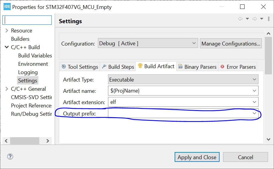

STM32CubeIDE v1.9.0 throws null exception when building project that works in v1.8.0
Throws this incredibly descriptive error:
Errors occurred during the build.
Errors running builder 'CDT Builder' on project 'App'.
java.lang.NullPointerException
I tried cleaning and re-importing the project, and the error persists. If I go back to v1.8.0, it works fine. Anyone have a work around for this?

After some analysis we found the issue. It is a bit of a corner case which effects customers who are migrating projects from any previous version of CubeIDE into 1.9.0. But only if the customer has touched the Output prefix setting.
0693W00000Kbvq3QAB.pngIf this field has been touched, and the user has clicked Apply or Apply and Close, a line will be injected into the .cproject file. This line has changed format in 1.9.0. Actually it can also be one line per build configuration --> potentially several lines!

How to fix the issue in CubeIDE?
  • Remove the faulty line manually from the .cproject-file.
  • If the Output prefix field still is needed, use the GUI to apply your prefix, and a new line will be added into the .cproject-file with the correct format.

In your case @BStic.2​ you are not using this option at all in your project. Our guess is that you probably just played with this option long time ago then clicked Apply. Then removed your change, clicked Apply. As a consequence you have the line in your .cproject-file with an empty value.
So, assuming that you just clean the line, your project should be running fine in any version of CubeIDE.
Thanks for bringing this corner case defect to our attention!

Great! Thanks! I was able to compile my project.
