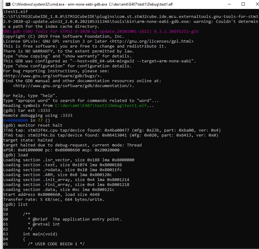

I need to write code using STM32CubeIDE for the STM32F407ZG on the STM32-E407 dev board from Olimex. The dev board is connected to the PC running windows 10 via the Olimex ARM-USB-OCD-H Jtag debugger.

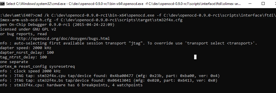

I installed the drivers (WinUSB (v6.1.7600.16385)) for the ARM-USB-OCD-H using Zadig, then run openocd (openocd-0.9.0-rc1).
To test it, I created and built a simple program using STM32CubeIDE. In another terminal, I run arm-none-eabi-gdb.exe. I can connect to the openocd and program the board.
0693W00000HrU3xQAF.pngEverything is working so far.

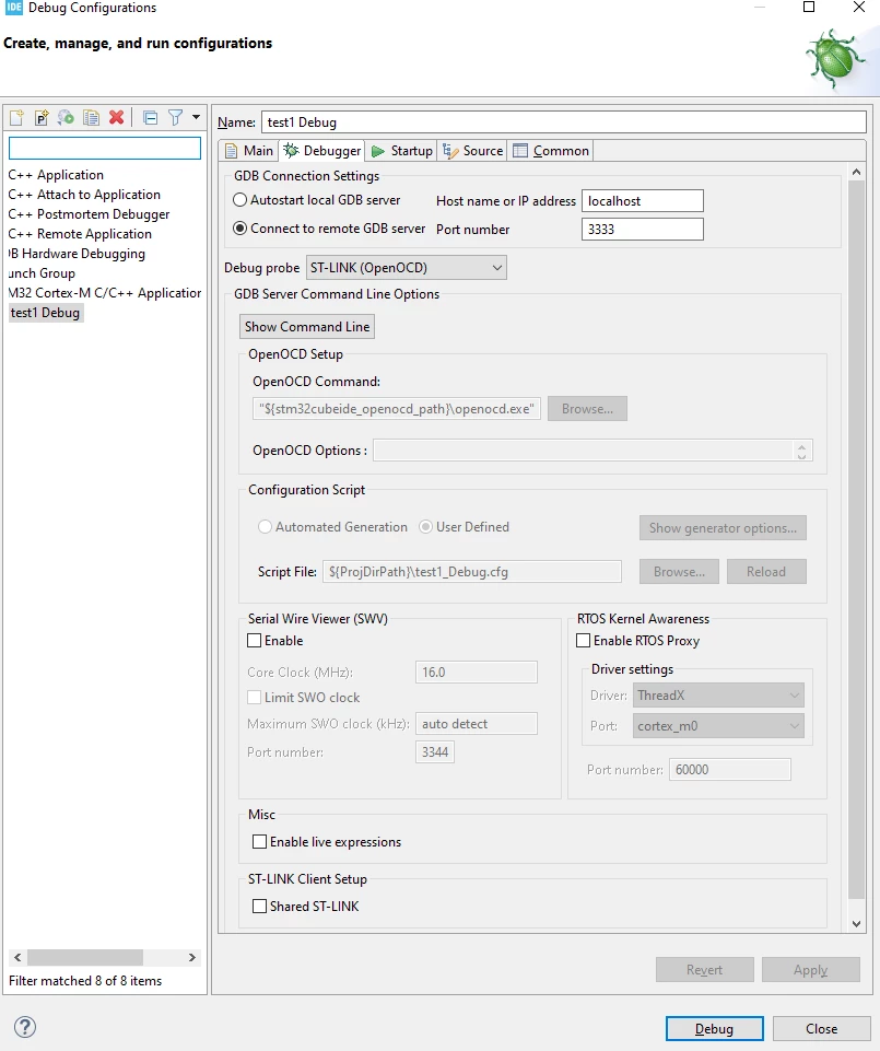

This is my debug configuration settings:
0693W00000HrU0jQAF.pngUsing STM32CubeIDE version 1.6 and with the same settings and same program, I can load and debug the program.
