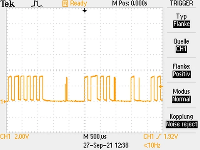

Since 25 years I use functions or macros like
#define usTimeRead() ((int16_t) (SysTick->VAL >> 1))
#define usTimePlus(TP, US) ((int16_t) TP - ((int16_t) US * (int16_t) 85))
#define usTimePast(TP) (((int16_t) TP - usTimeRead()) > (int16_t) 0)
to create timeouts or to do periodical jobs on 16bit MCUs.
Porting them to STM32G4, the following code should result in a 100us square wave generated at pin B6.
int main(void) {
 sysConfigMCU();
 /* Loop */
 int16_t tp = usTimeRead();
 for(;;) {
	GPIOB->BSRR = ((uint16_t)0x0040);
	tp = usTimePlus(tp, 100);
	for ( ; !usTimePast(tp); );
	GPIOB->BRR = ((uint16_t)0x0040);

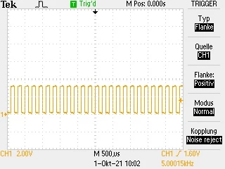

This doesn't work - I have to change the macro usTimePast(TP) assigning the difference to temporary variable to get the program running correctly.

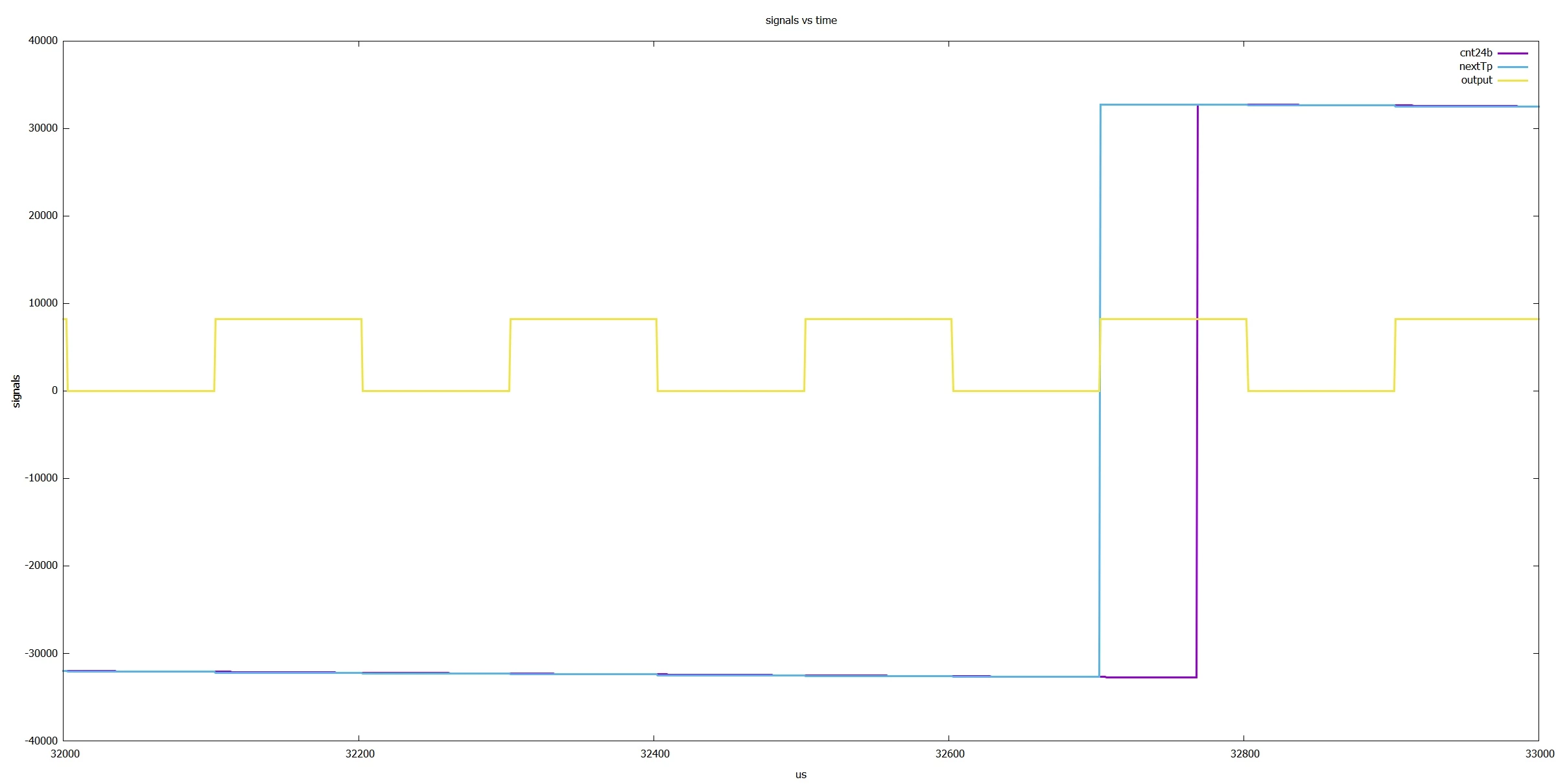

#define usTimePast(TP) ((tmp = (int16_t) TP - usTimeRead()) > (int16_t) 0)

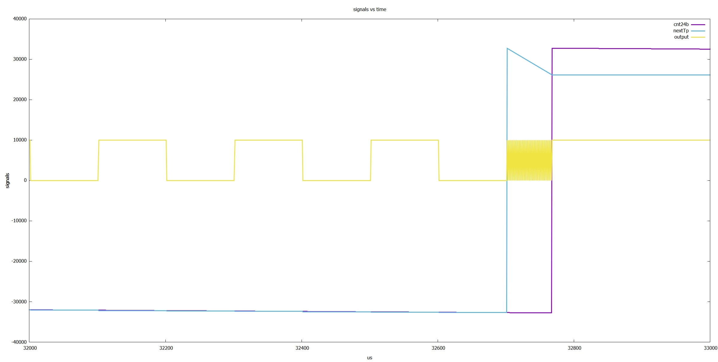

I've simulated this behaviour with TDM-GCC with the same result - for values like
usTimeRead() == -32703 and tp == 32735 the compare in usTimePast(TP) will produce differnt results depending on weather the difference of the left side of compare will be assinged to a temporary variable or not!
Using Microsoft Visual Studio will prodece in both cases (with and without aasigning the difference to a temporary variable) the behaviour i know from 16bit MCUs and their compilers.

Tests with Microsoft Visual Studio has been done by a friend - he reported, the output signal will not toggle in the data file like in my data file,
when cnt24b reaches  -32703.
# usTick cnt24b nextTp output
 32699 -32700 -32701 0
 32700 -32701 -32701 0
 32701 -32702 -32701 0 <===
 32702 -32703 32735 10000
 32703 -32704 32635 0
 32704 -32705 32535 10000
 32705 -32706 32435 0
 32706 -32707 32335 10000
 32707 -32708 32235 0
 32708 -32709 32135 10000
 32709 -32710 32035 0
 32710 -32711 31935 10000
I will check using unsigned arithmetic next week (the compare has to be a signed compare).
Inspired by yout test I will also check, if casting the difference of two int16_t again to int16_t will also solve the problem -
yout test implies, that the difference of two int16_t isn' t treaded as an int16_t (at least, when an underflow or overflow
has been ocured).
ULehm.1
ULehm.1Author
October 1, 2021
Ok - casting the difference again to int16_t is enough to get the same behaviour like assigning the difference to an int16_t temporary variable!
Wth STM32 compiler as well as with the TDM-GCC compiler.
It seems, the difference of two int16_t does not have to be an int16_t?
