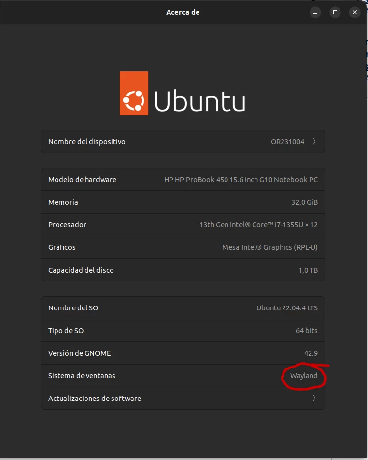

I would like to report that STM32CubeIDE is freezing when running on Wayland session.
The solution I found is to start Ubuntu in a X session.

    Apr 2, 2024 7:02 PM UTC
    It is not that the IDE crashes, but it stops updating the window, so it freezes and it is impossible to work with it.
    The configuration in which this happens is:
    It works fine in X11

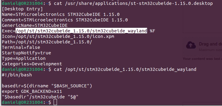

    The STM32CubeIDE uses this shortcut:
    user7
    Apr 2, 2024 8:34 PM UTC
    take a look at the contents of the file that you have marked in the screenshot. It has the same name than the file I mentioned. You can open it in your preferred text editor (e.g. kate). Does it have the export GDK_BACKEND=x11 entry? If not, add it.

    I tried your solution (adding Adwaita theme) but it doesn't work.
    The file already contained GDK_BACKEND=x11 theme entry.
    STM32CubeIDE stops working randomly normally when I switch the Window back to STM32CubeIDE after working in another window.
    I am falling back to X11 and it works flawlessly.

    Dec 3, 2024 2:49 PM UTC
    I've just encountered this problem, today. The answer, for me, was to remove GDK_BACKEND=x11 from /opt/st/stm32cubeide_1.17.0/stm32cubeide_wayland
    Jan 5, 2026 8:23 AM UTC
    I was also seeing this problem after a recent upgrade of Ubuntu in which support for X11 was removed (due the upgrade including a Gnome update that doesn't support it anymore).
    Removing GDK_BACKEND=x11 fixed the issue. It's peculiar to see a reference to X11 in a file suffixed _wayland, and I wonder why this line was in there. Perhaps someone from the CubeIDE team can shed some light on this.

    Jan 21, 2026 10:42 PM UTC
    I had the same issue. As a temporary solution you can run the IDE in terminal like:
    `unset GDK_BACKEND && /opt/st/stm32cubeide_2.0.0/stm32cubeide`
    or
    Create a file at ~/.local/share/applications/stm32cubeide-wayland-fixed.desktop with the following content (adjust the
    version path as yours):
    [Desktop Entry]
    Name=STM32CubeIDE
    Comment=STM32CubeIDE with Wayland fix
    GenericName=STM32CubeIDE
    Exec=env -u GDK_BACKEND /opt/st/stm32cubeide_2.0.0/stm32cubeide %F
    Icon=/opt/st/stm32cubeide_2.0.0/icon.xpm
    Path=/opt/st/stm32cubeide_2.0.0/
    Terminal=false
    StartupNotify=true
    Type=Application
    Categories=Development
    The key is using env -u GDK_BACKEND which unsets the variable before launching the IDE. After creating the file, run
    update-desktop-database ~/.local/share/applications and the new launcher will appear in your application search.
    This is not a perfect solution but hopefully resolves the UI freezing part.
