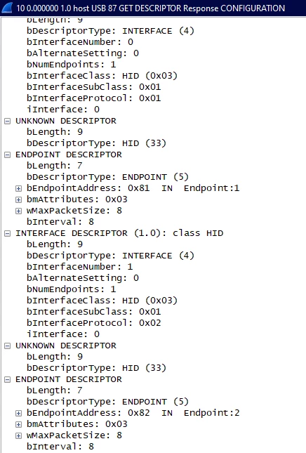

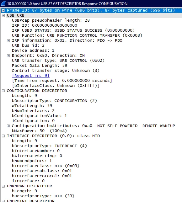

I noticed that the library found two interfaces.
How can I receive data from both interfaces at the same time?
It seems that the library is implementing only the first interface, and when the touchpad is triggered the library gets lost and stops responding.

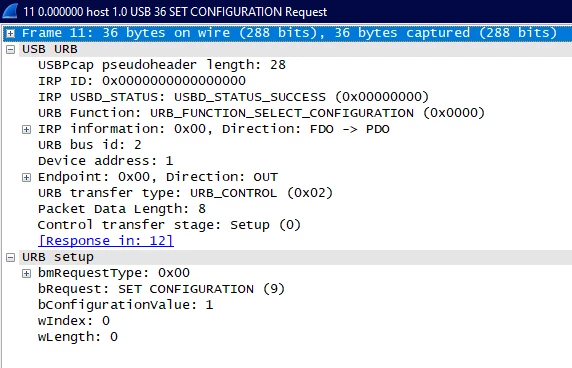

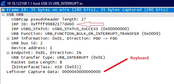

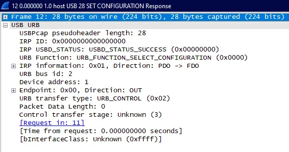

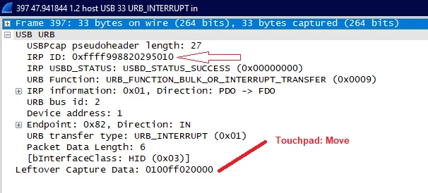

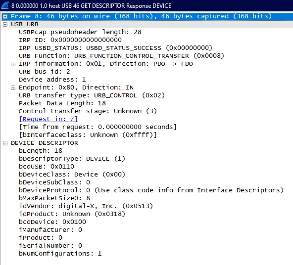

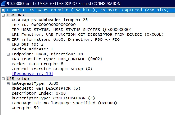

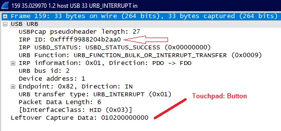

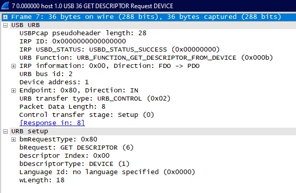

Got some data on Windows using USBPcap
1-Descriptor Request DEVICE:
2-Descriptor Response DEVICE:
3-GET DESCRIPTOR Request CONFIGURATION:
4a-GET DESCRIPTOR Response CONFIGURATION:
4b-GET DESCRIPTOR Response CONFIGURATION:
5-SET CONFIGURATION Request:
6-SET CONFIGURATION Response:
7-URB_INTERRUPT in:
8-URB_INTERRUPT in:
9-URB_INTERRUPT in:

I may have found the answer to this keyboard not working.

I manually set it to handle only the second interface and now things have reversed, the HID process no longer recognizes the keyboard keys but recognizes the touchpad buttons and movements.
File usbh_hid.c: (interface = 1)
static USBH_StatusTypeDef USBH_HID_InterfaceInit (USBH_HandleTypeDef *phost)
	uint8_t max_ep;
	uint8_t num = 0U;
	uint8_t interface;
	USBH_StatusTypeDef status = USBH_FAIL;
	HID_HandleTypeDef *HID_Handle;
	interface = 1; // USBH_FindInterface(phost, phost->pActiveClass->ClassCode, HID_BOOT_CODE, 0xFFU);

Key of keyboard pressed:

USB Device Attached
PID: 318h
VID: 513h
Address (#1) assigned.
Manufacturer : N/A
Product : N/A
Serial Number : N/A
Enumeration done.
This device has only 1 configuration.
Default configuration set.
Device remote wakeup enabled
Active Class: 3, Interface: 0
Number of Interfaces: 2
Switching to Interface (#1)
Class   : 3h
SubClass : 1h
Protocol : 2h
Mouse device found!
HID class started.
Mouse action: x= 0x1, y= 0x0, button1 = 0x0, button2 = 0x0, button3 = 0x0
Mouse action: x= 0x0, y= 0x0, button1 = 0x1, button2 = 0x0, button3 = 0x0
Note that the HID process restarted when a key was pressed. So the problem is dealing with both interfaces, the library is working with only the first interface (0).
