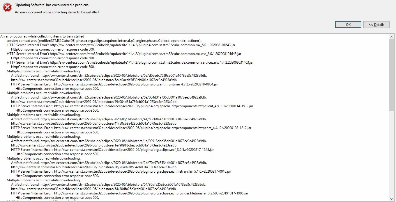

STM32CubeIDE update is not happening from version 1.4.0 to version 1.4.2. There was error like 'Updating STM32CubeIDE is encountered with problem'
STM32CubeIDE update is not happening from version 1.4.0 to version 1.4.2. There was error like 'Updating STM32CubeIDE is encountered with problem'. Please help me on this because one of my team member created project in STM32CubeIDE 1.4.2 , I have to use it.

​Please find the error logs as attached and machine is running with Windows 10 OS

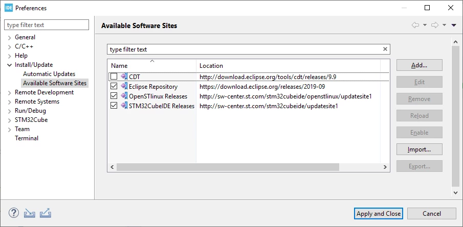

Looks related to the recent issue with the software site repository.
Could you remove the local software updater cache by deleting those 2 directories from your STM32CubeIDE installation:
STM32CubeIDE\p2\org.eclipse.equinox.p2.core\cache
STM32CubeIDE\p2\org.eclipse.equinox.p2.repository\cache
Make sure that the Software Sites URLs are well those by default:
0693W000005AjI5QAK.pngAnd try to update again (Help > Check for update)
