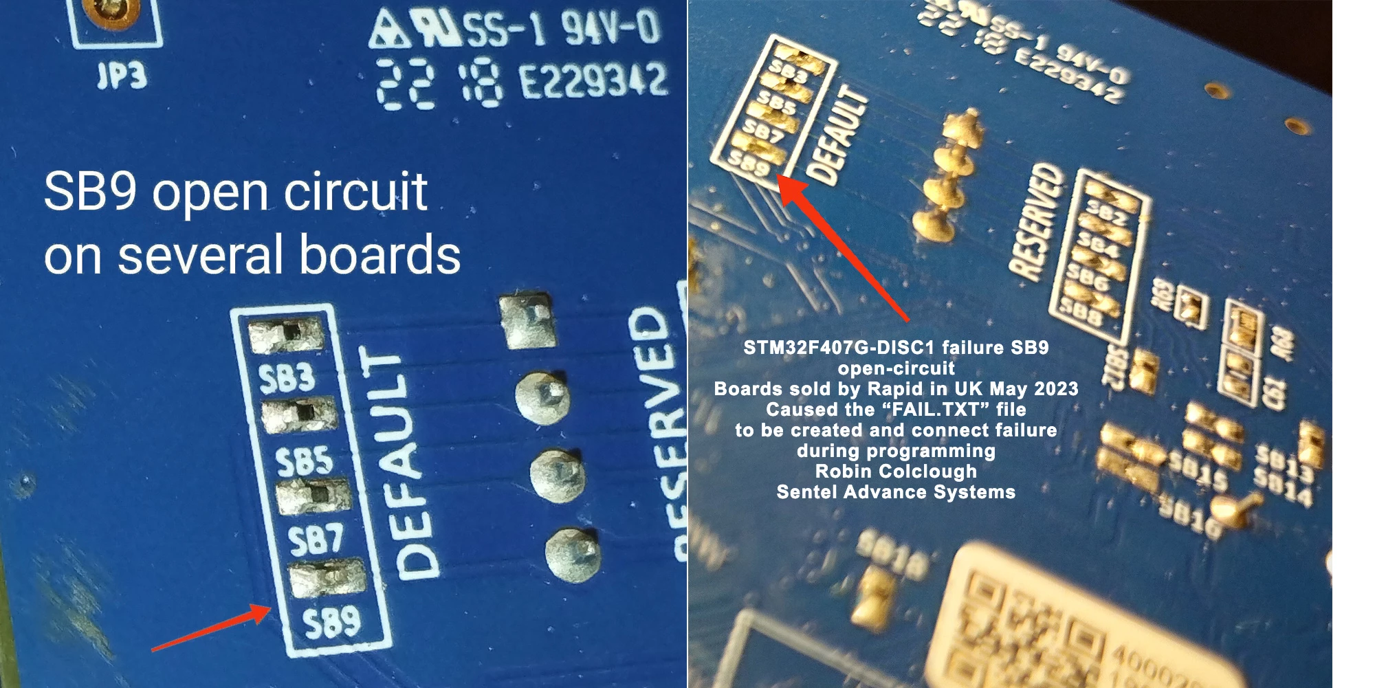

After the July 10 STM32CUBEIDE update our STM32F407VG boards are no longer being detected, with the error "STM Error: No STM target found"
I've tried all the usual settings to recover, STM32CubeProgrammer, Mode under reset, powerdown, nothing lets me connect.
I can update the ST-Link firmware, but that's it.
The board continues to run any software previously installed, and have tried updating several boards that updated perfectly yesterday, but any updating of the ST-LINK firmware now causes the connection to be lost.
One strange thing, with the updated STM32CubeIDE, it request to update the link firmware if the Programmer updated previously, seems they are both using different versions.  I did update the programmer too.
Any ideas how to fix?

    It is simple, following the last firmware update to the CubeIDE, now when I build our application the first time it lists those 9 errors, if I click build again, it builds without errors, and if I click it again, it lists 9 errors,... and so on.
    The STM link error is another issue, on some boards after the first programming
    attempt we get the link failure message and the file Fail.txt appears with the message: The interface firmware FAILED to reset/halt the target MCU.
    Tried the suggested methods to connect, reset down, BOOT0 to VDD, to no avail.
    Read the post about voltage levels, so if it's useful: from the Debug USB connection it gives 2.96V on VDD, and 4.66V on VCC.
    Robmar
    RobmarAuthor
    Senior II
    July 26, 2023
    UPDATE: The STM link failure that causes the "FILE.TXT" message to be created on the USB Debug folder seems to have been caused not by the IDE update (which causes the intermittent link errors), but by a component fault on the STM32F407G-DISC1 boards.  SB9 has a 0 ohm resistor chip, the components look different to its neighbours and is open circuit. Soldering it and closing the link fixes the Link failure.STM32F407G-DISC1_SB9_fail_20230725.jpg
