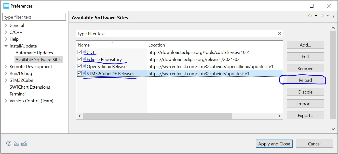

mattias norlander
Mar 8, 2022 9:19 AM UTC
Could you try in your CubeIDE 1.7.0 installation to do this:
Window > Preferences > Install/Update > Available software sites
Try to Reload, the marked three update sites:
0693W00000KblwVQAR.pngAny error message?
