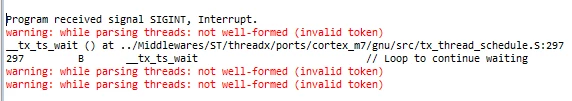

RTOS-aware debugging for ThreadX breaks completely when at least one ThreadX thread name length exceeds ~20 characters.
ThreadX itself has no limitation on thread name length (thread name is CHAR *).
However, STM32CubeIDE RTOS-aware debug stops working if any thread name is longer than ~20 characters.
When this happens:
  • RTOS thread list becomes incomplete or unusable
  • Switching between threads is not possible
  • Call stack for inactive threads is missing
  • GDB console shows warnings like:
    warning: while parsing threads: not well-formed (invalid token)
RTOS-aware debugging works correctly only when all ThreadX thread names fit into a 20-byte buffer including the null terminator (maximum 19 visible characters).
The issue is 100% reproducible.

However, I think there is a misunderstanding regarding the issue.
The problem is NOT the ThreadX Thread List UI view itself.
Indeed, the UI correctly shows truncated names (e.g. "Disk Manager Init Threa"),
and this part works as expected.
The issue occurs specifically in RTOS-aware debugging via GDB using RTOS Proxy,
i.e. during qXfer:threads:read communication between GDB and the proxy.
When at least one ThreadX thread name length is ≥ 20 characters (including the terminating '\0'),
RTOS Proxy generates malformed XML for qXfer:threads:read.
As a result:
- GDB reports: "warning: while parsing threads: not well-formed (invalid token)"
- `info threads` becomes unreliable or incomplete
- switching threads (`thread <N>`) fails or shows incorrect context
- call stacks for non-active threads cannot be retrieved
- in some cases RTOS Proxy crashes with "Invalid offset"
This is reproducible 100% of the time.
If all thread names are shortened to ≤ 19 characters (so that '\0' fits),
RTOS-aware debugging immediately works correctly again.
