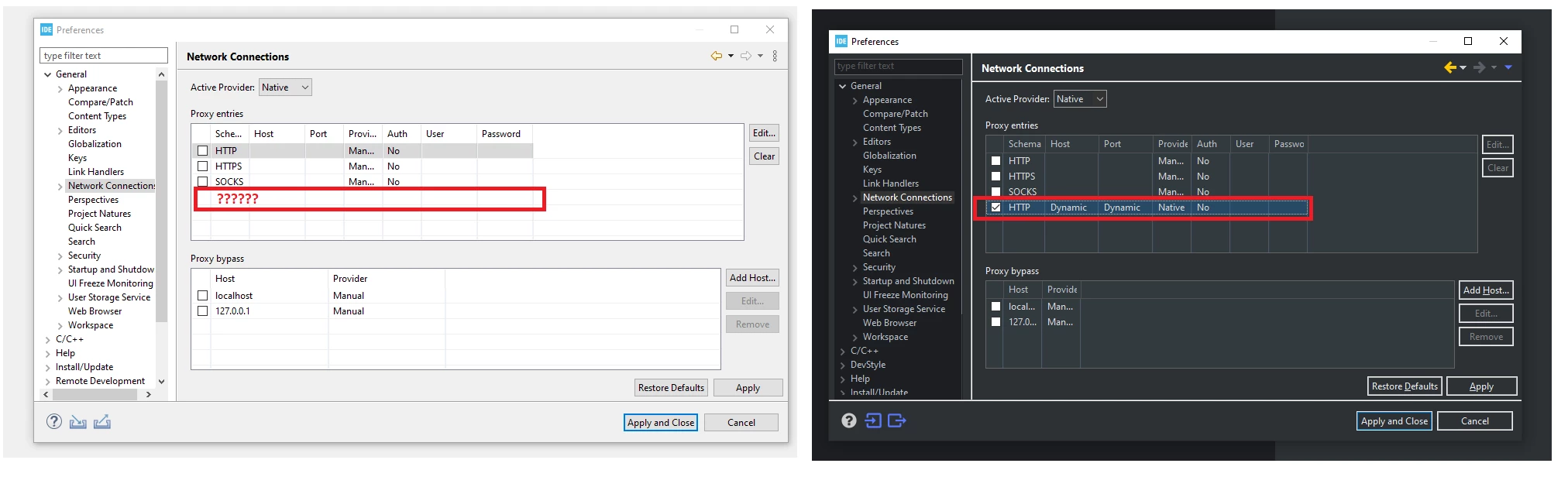

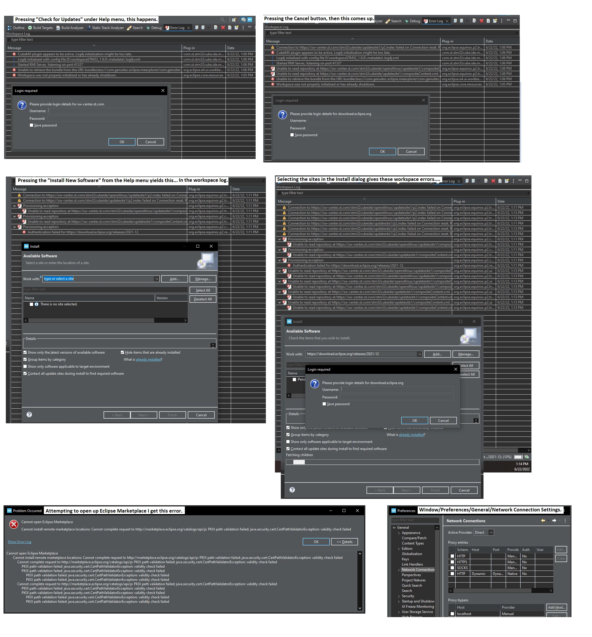

Marcus, thanks for getting back to me. I changed the Windows/Preferences/General/Network Connections selection from Native to Direct and it no longer gives the dialog(s) when starting the IDE up. But, When I attempt to check for updates, or install software. I get them and errors in the workspace log. (screenshots attached). It also fails when I try to go to the Eclipse Marketplace. (Again errors included in the screenshot.) I am wondering if the Company firewall is preventing the IDE from going to the websites for the updates/marketplace? This seemed to work on older revisions of the IDE. Any help is appreciated.

If you are on a company network (like I am) then you will most likely need to set the Active Provider from Direct to Manual and then enter a host, port and user authentication.
This is only needed if you want to access online resources via STM32CubeIDE, such as using the check for updates or using the Eclipse Marketplace.
Functions such as downloading the latest FW or version of STM32CubeIDE can still be done manually through accessing st.com from any web browser. However, doing it through STM32CubeIDE will require the connection to be set up according to your companies requirements.

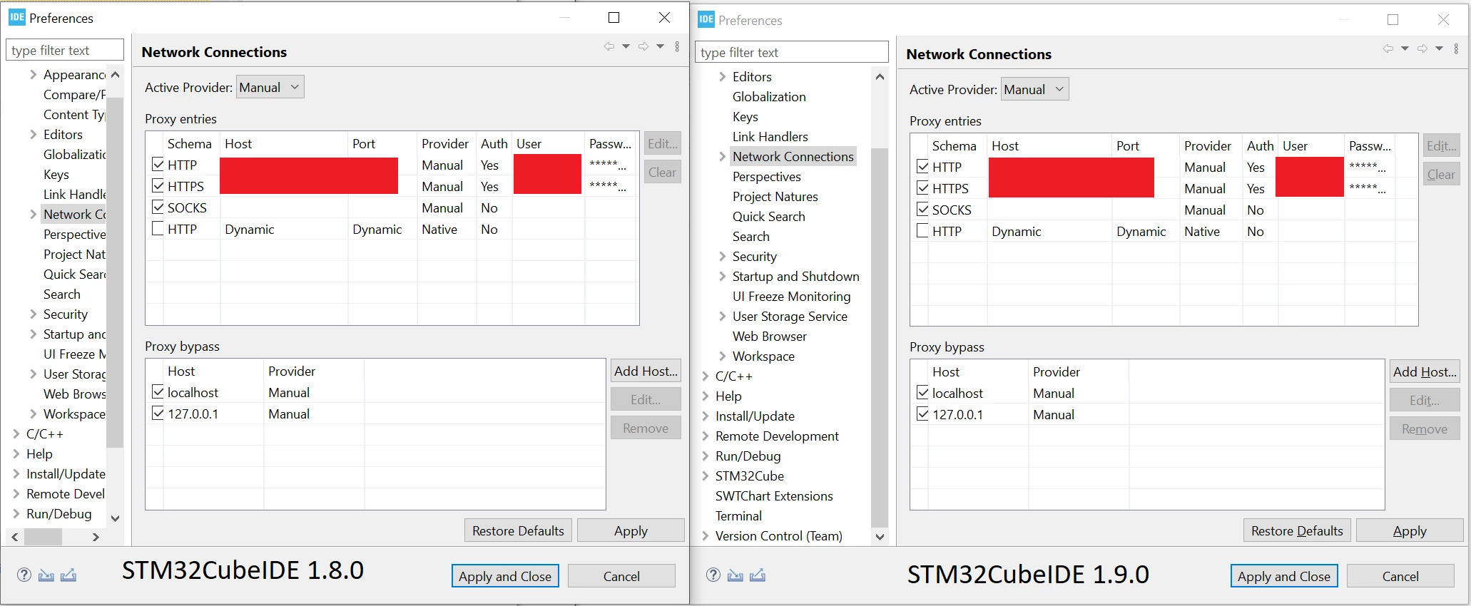

Markus, looking under Window>Preferences>General>Network Connections and there is a difference in the entries between v1.8.0 and v1.9.0.(See Pic.) First would this difference cause v1.9.0 to not be able to connect to software update sites? If so, is there a way to add an entry to the Proxy Entries window to duplicate what is in v1.8.0? I tried to export the preferences from v1.8.0 and import them into v1.9.0 but that did not seem to work. (on restart the entry was not saved.) Any info would be appreciated.

Hmm, I tried to do the same thing from my end but I don't get the same result. I'm not sure if anything was changed due to me previously having set-up my corporate login but this is how it looks for me in both versions:

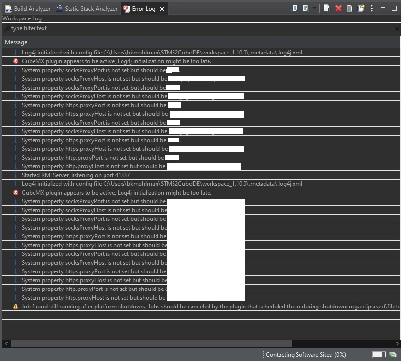

Markus, I have the Host/Port/Proxy information and have entered it in the Window/Preferences/General/Network but when I go to update the software it sits and spins. There are messages in the error logs. (Pic Attached.) Where do I enter the information in System Properties?
