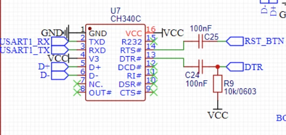

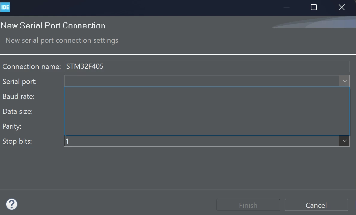

I  have a STM32F405 and am trying to setup UART to connect to my pc. As of now I have connected it with an ST-Link/V2 and later on want to program it over USB-C using UART. See the wiring diagram:
I have used PA10 and PA9 for RX and TX.

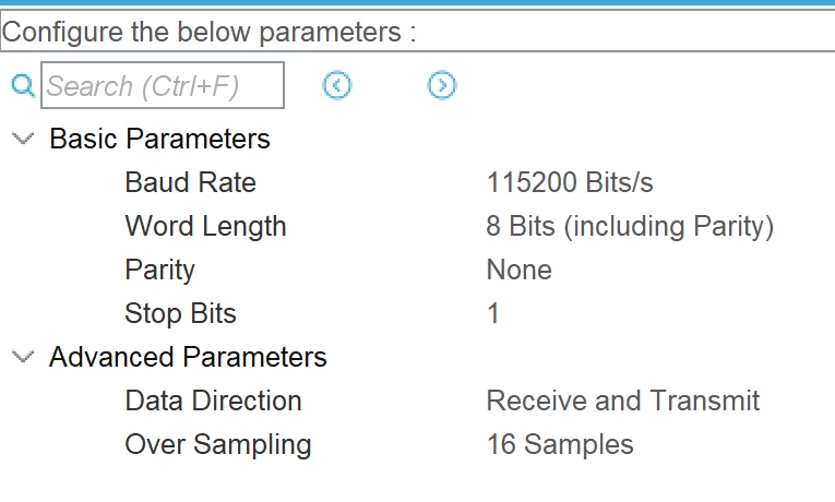

The parameter settings are as followed:

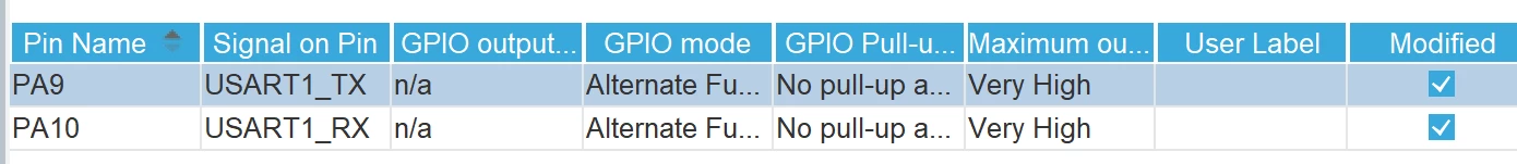

When it comes to the GPIO settings I have set the maximum output speed to "Very High" (not sure if this is correct).

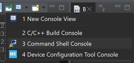

I have watched a guide on YouTube (https://youtu.be/dnfuNT1dPiM?t=4896) about how to getstarted in the STM32CubeIDE and stopped on the part about the "Command Shell Console":

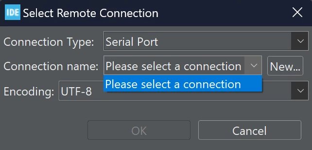

At "Connection name" I had none and preesed "New..."
Now on the "Serial port", I dont know what to do. See image:
I am using a Windows 11 computer and heard something about using Tera Term or Putty, but I dont know how.
Can someone explain some more about the Serial port setting?

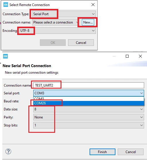

    " I have set the maximum output speed to "Very High""
    Not optimum but it works. I suggest Low to set them to low instead of very high.
    Now regarding the config of the Hyperterminal:
    You need to check what is the Comport number assigned by windows on your computer. You need to go to Device manager on your computer and go to Ports (COM & LPT) list:
    This is what I found as comport number : COM26. You can find another number. This is what you need to put in Serial port in the CubeIDE console:
    Hope I answered your question.

    Thank you for your reply @mƎALLEm .
    I will set the Maximum output speed to low then.
    Yes, this answers my question.:beaming_face_with_smiling_eyes:
    I however don`t seem to get any Comport when I plug my USB-C cable to the STM32F4.
    Could this have something to do with the settings in the bootloader perhaps?

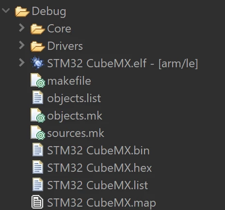

    I have tried using the .bin file which is located in the "Debug" folder when I generated my code.
    Do you have any tips regarding this?
    Thank you!
    mƎALLEm
    April 23, 2024
    No relation to bootloader or anything else.
    The Comport is part of ST-Link module and not to the target MCU.
    You need to find and get a new Comport number in the "Ports" list as shown above, otherwise you have an issue on ST-Link module side.
    Are you using a rechargeable cable or data cable? you need to use a data cable otherwise it won't work.

    You've got a driver for this CH340C ? Installed and working?
    You can see it in Device Manager? At what COM port.
    April 23, 2024
    Hey @Tesla DeLorean ,
    I have forgotten totally about the driver for the CH340C. Very good shout thank you!
    I will download the driver and give it a shoot :folded_hands:
