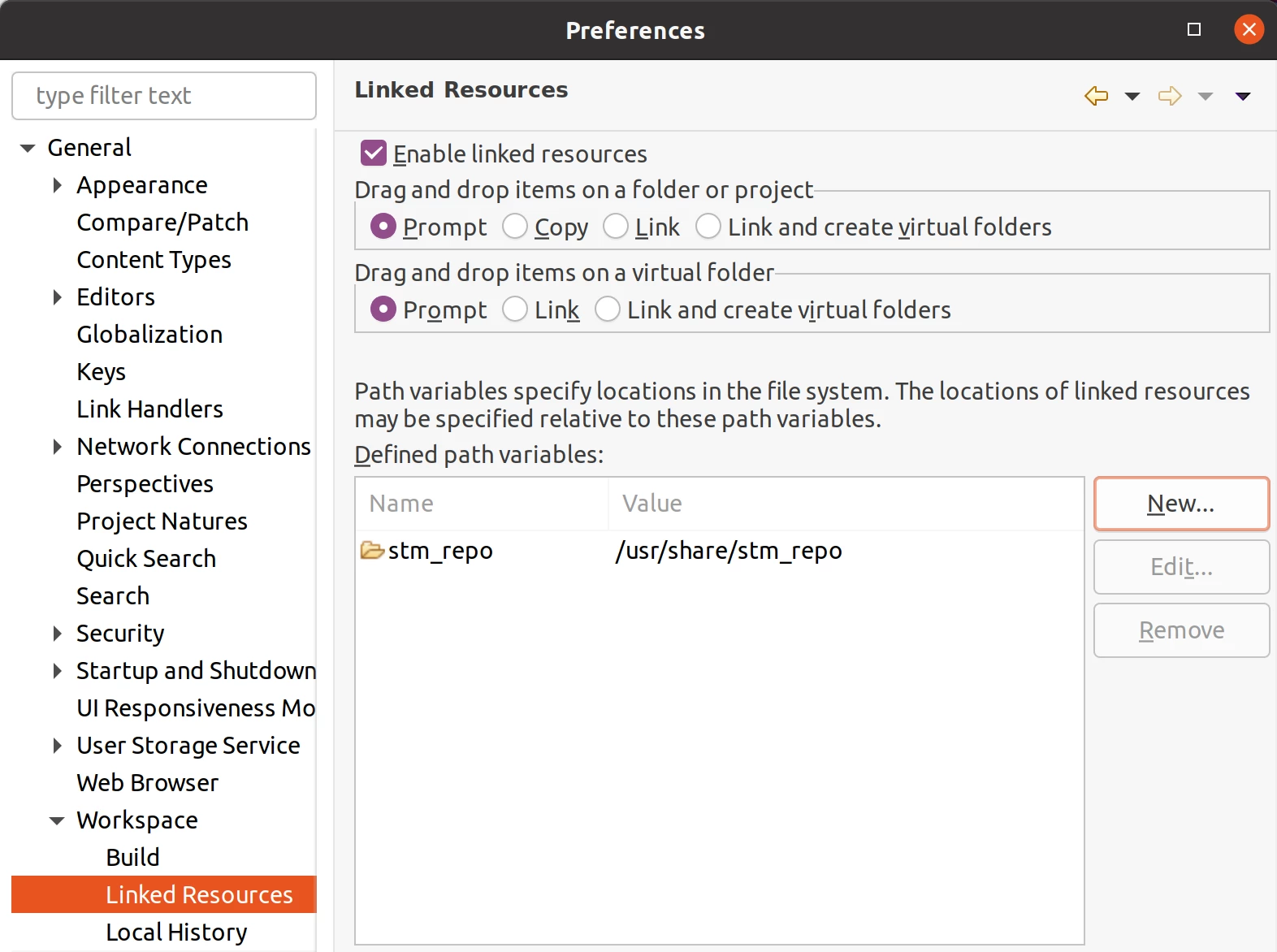

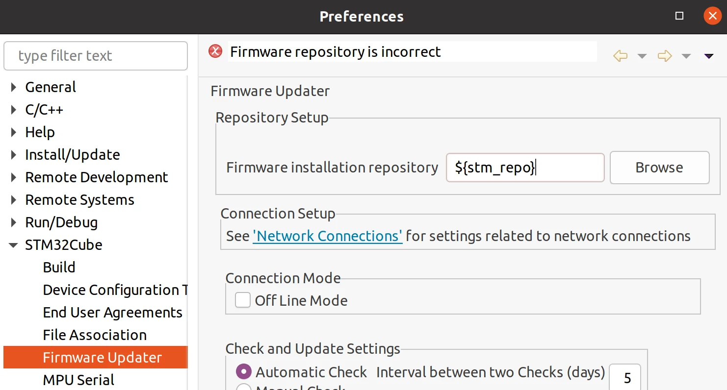

Miles1
Miles1Author
Aug 30, 2020 8:52 PM UTC
Thanks for the advice Pavel.
To clarify the steps:
1. Create a symlink to the stm repo:
sudo ln -s ~/STM32Cube/Repository /usr/share/stm_repo
2. Add this as a path variable in "Window > Preferences > General > Workspace > Linked Resources"
3. Use this path variable for the firmware repo in "Window > Preferences > STM32Cube > Firmware Updater".
Unfortunately, I can't figure out how to just use the "stm_repo" variable, and must instead use "/user/share/stm_repo".

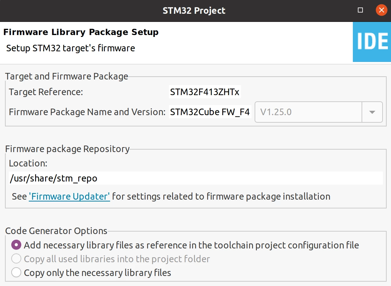

4. Create a new project. It will point to the same path set in the firmware updater.
Unfortunately, there are still lots of paths hardcoded for my machine in this project:
