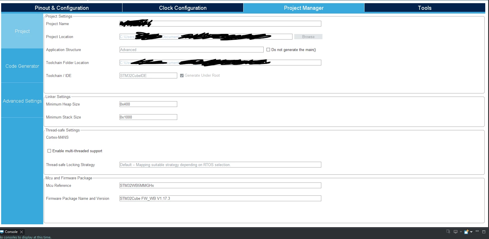

I can remember that the Project Manager tab of the STM32CubeIDE showed an option to change the used firmware package. In my current project I'm not able to do that. When opening the .ioc file the used FW package is version 1.17.3, while the IDE actually has version 1.18 installed already.
Is this some kind of bug? Or intended behaviour? How do I change the project to use the latest FW for the MCU?
I just noticed it in IDE version 1.14, but an update to the current vresion 1.15 did not change it.

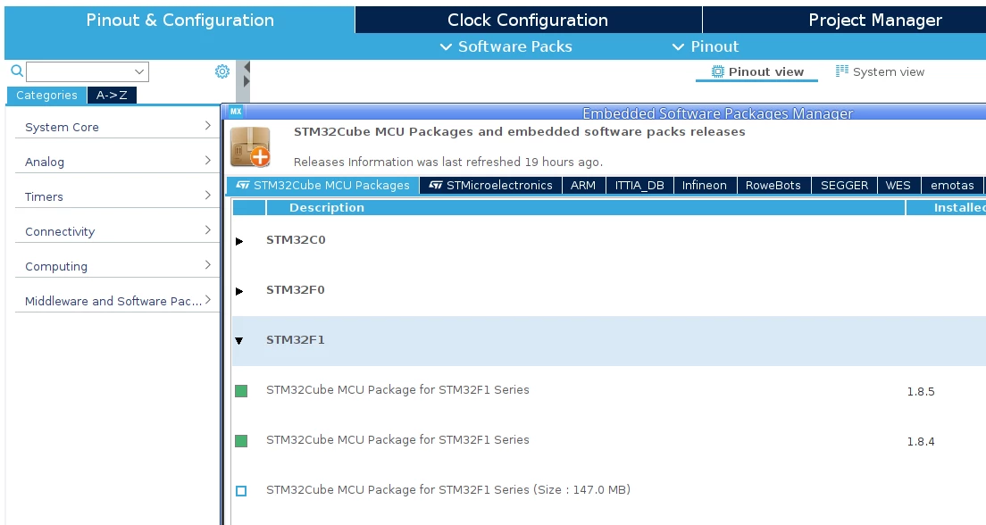

May 2, 2024
Go in Cube to -> software packs -> manage..  and select/install...if there a more recent version.
On open Cube/ioc , -> migrate , to use new version.

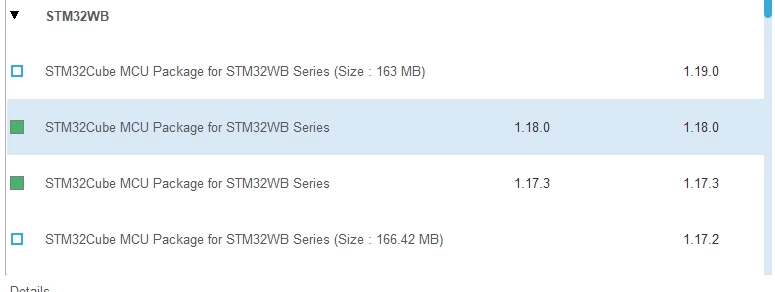

I have installed FW version 1.17.3 and 1.18. The project currently uses version 1.17.3
But I have no clue how to change that to the newer version 1.18. When I open the .ioc file I don't get the popup asking to migrate the project. And the project manager does not offer the possibilty to change it either (see screenshot in first post).

Strange...
I would try : install version 1.19.0   also, then try again. (Maybe : close IDE, start again...)
It should show the migrate/continue window ...
