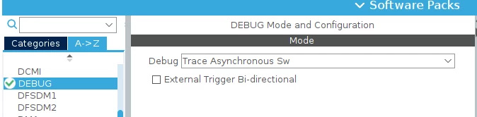

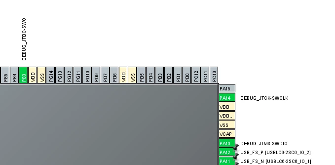

    AScha.3
    April 14, 2024
    Tip:
    Always set in Cube (at first ! ) the debug connection you want to use enabled :
    because this is on GPIOA :
    So if you not do this, and use these pins for anything else - you stop any debug connection at this moment.
    RogerMcAuthorBest answer
    April 15, 2024
    Changing all occurrences  of GPIOA to GPIOB has all other problematic lessons working.
    Thanks all for good advice.
