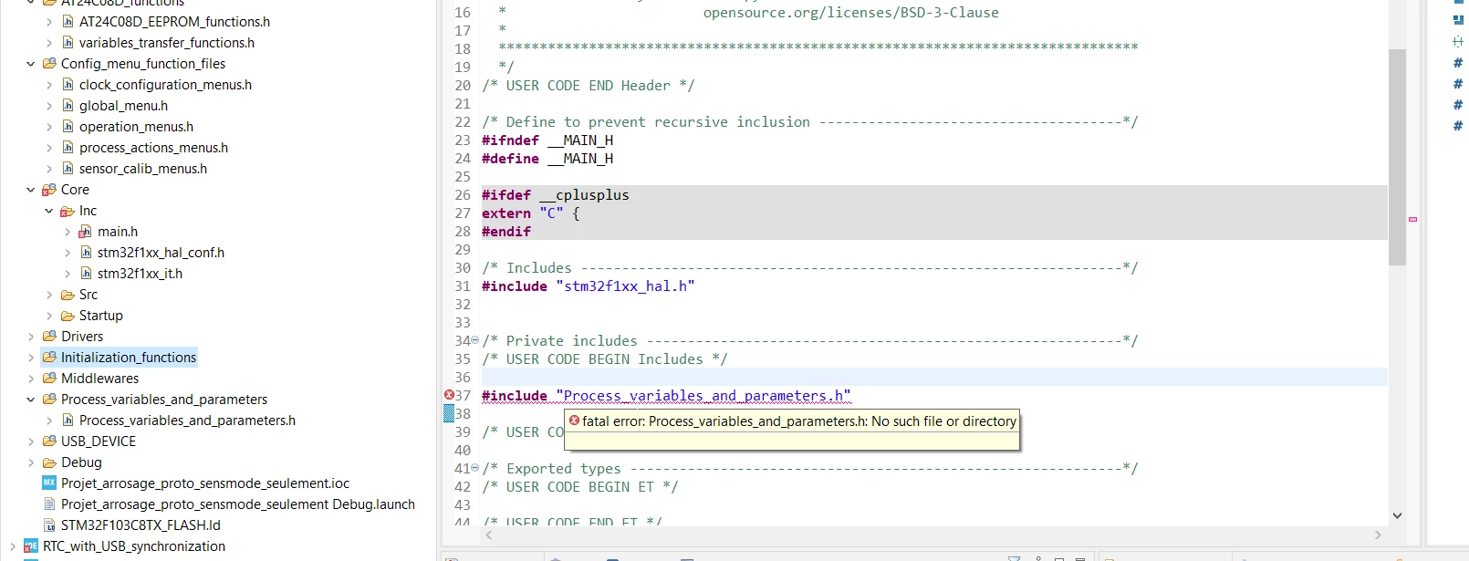

I know this has been discussed before before, but for some reasons, I still can't make my project compile without having errors in it, because of including one file. I have included the path in "Paths and Symbols" tab.
Code in "main.h" file
This is the only line of code I added in the main.h file. What is inside this file is as it follows:

Basically those are values, most of them contained inside structs. I had another case of problems with including a file in another project and both have in common that I'm defining a variable based on a struct (in the other one though, I'm just defining a time variable based on the RTC_TimeTypeDef variable type).
I'd like to know if it's because there are some errors in the code preventing compilation or something else. Thanks for the answer already.

the fatal error says that it cannot find the .h file. Fix that first. The .h file content is irrelevant at that point. Sometimes, the error messages show in the GUI are outdated, try F5 (Refresh) and re-build. But, if the error persists, double check that you have added the correct path under "Paths and Symbols" > "Includes" for the configuaration you are building. In the Build Console, the compile lines "arm-none-eabi-gcc "../Drivers/STM ..." contain all include paths (-I) gathered from the GUI settings.
hth

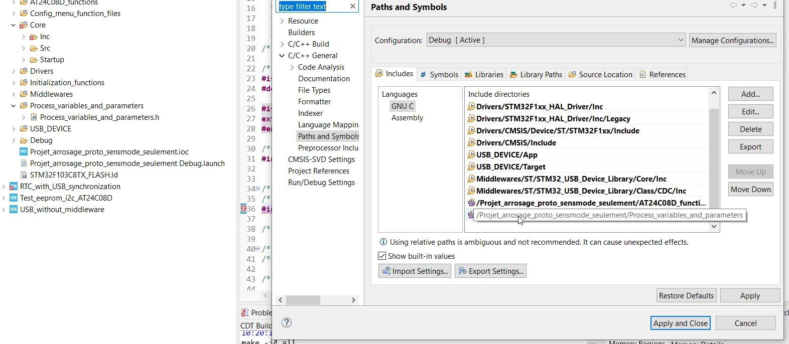

So, I tried to refresh, but nothing really changed. Also, I can show you my Paths and Symbols GUI
I don't really know where I did something wrong, because I have other files I have included in my project that had no issues during the process. (some of them are not included yet because I haven't used them yet) and had no issues at the stage of file inclusion. Like I said before, I had his problem in another project and both have in common that I either typedef a struct or declare a variable based on a typedef that already exists. Other files have none of this.

@FGerm.1​ Notice that all your include directories are marked with ! icon. Eclipse cannot find these paths.
If the .project is in a subdirectory of your project, the relative paths should begin with ../
Or better (as Eclipse suggests) avoid relative paths. Instead always begin the paths with ${ProjDirPath} or other variable that resolves to absolute path.
-- pa
