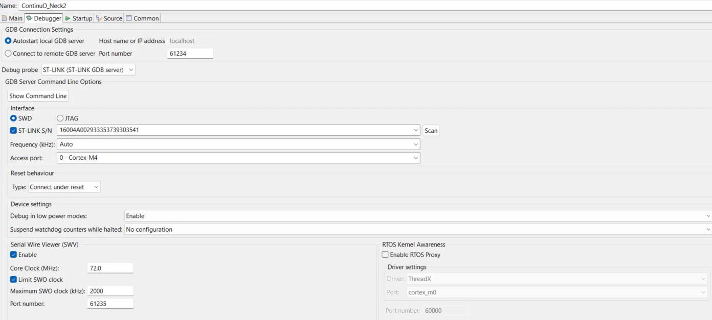

Good morning everybody,
I try to print in the console by using a ST-link 2 with SWD howerver I can't do it. I watached these 2 videos : https://www.youtube.com/watch?v=sPzQ5CniWtw & https://www.youtube.com/watch?v=JqrUAzjJ0tw

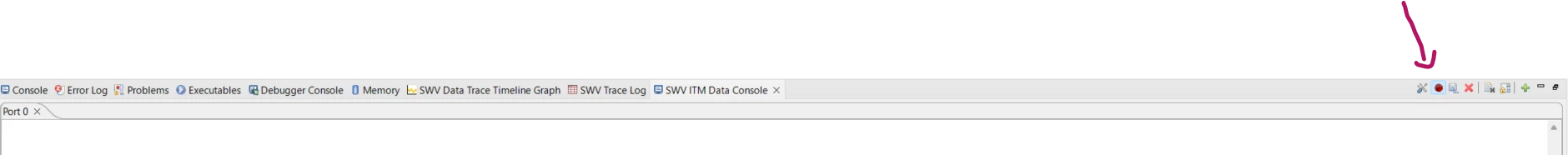

However I still can do it. My problem is when I press the "start race", it becomes red, but when I resume in the debugger, the red light disapears. Thanks in advance

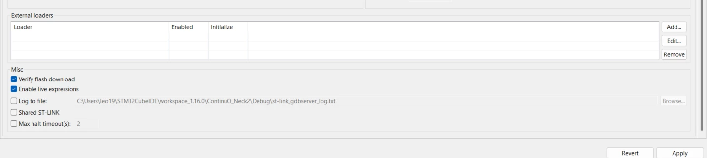

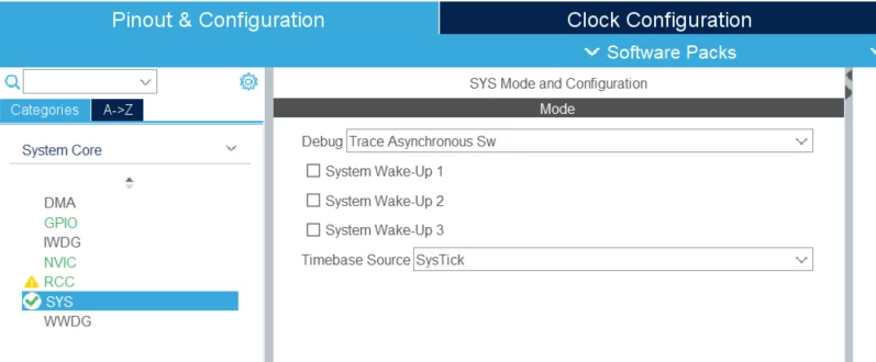

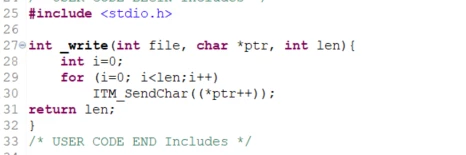

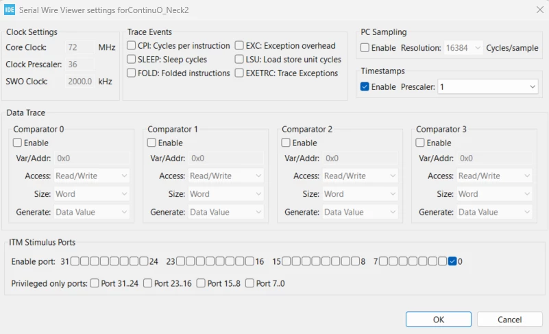

Here the different parameters that I put.
    1 reply
