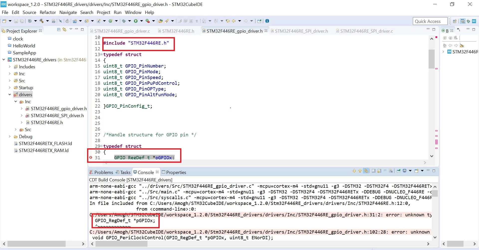

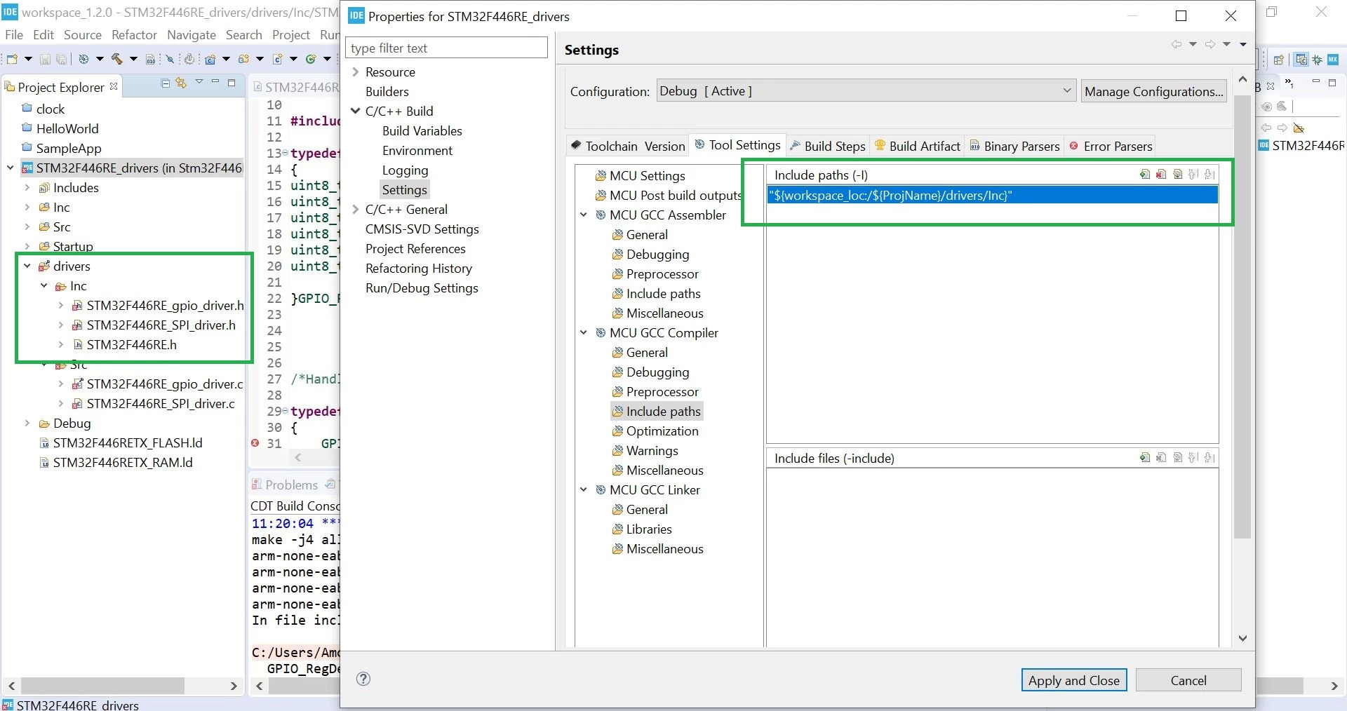

Hi all,
I am facing similar kind of situation. When the header file is included in the code it is not showing any errors but when built it does not recognize the hearder file included by giving errors for all the elements of the included heder file saying unknow type names. Any help would be appreciated.
I have even added the requred paths.
Please check the below screenshots of the error and added paths.
Thank you,

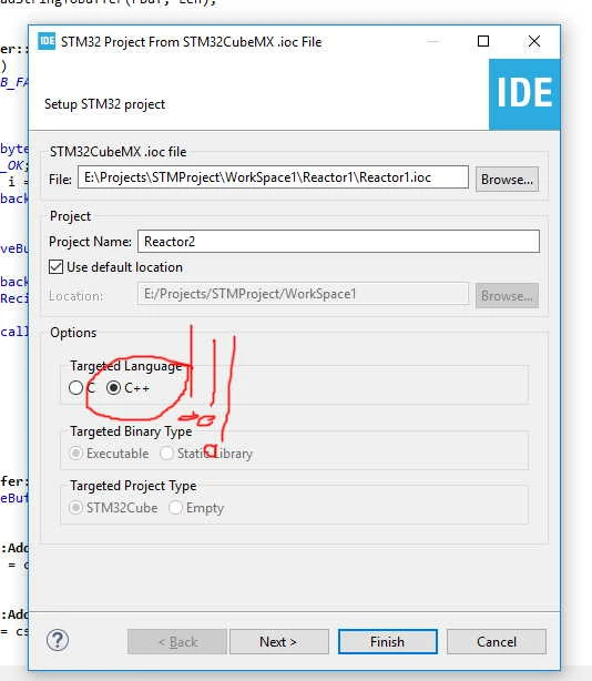

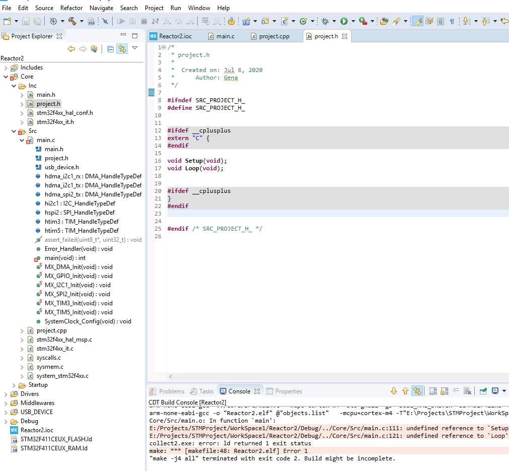

Hi! The same problem. If I create C++ project from .ioc file IDE don`t see #include function ( but see the included file) !
main.c
#include "project.h"
project.h
#ifndef SRC_PROJECT_H_
#define SRC_PROJECT_H_
#ifdef __cplusplus
extern "C" {
#endif
void Setup(void);
void Loop(void);
#ifdef __cplusplus
#endif
#endif /* SRC_PROJECT_H_ */
function Setup and Loop the compiler doesn't see them , as if they don't exist
But if I create project new STM32 project (not from .ioc file) all work true.
Who knows how to solve this bug !???

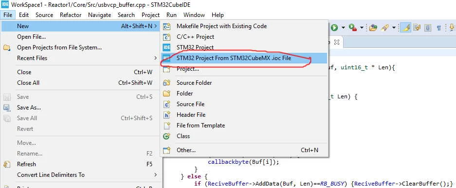

"But if I create project new STM32 project (not from .ioc file) " are you working with STM32CubeMX or STM32CubeIDE here ?
"all work true" means you have used File > New STM32 Project but which options then ? (Empty or STM32Cube project types ?)
Where is your project.h located on file system ? Possibly share a screen snaphot of your project showing includes setups and file structure ...
In meantime takes care could be same as : https://community.st.com/s/question/0D53W00000DJpGPSA1/file-added-and-path-added-but-still-get-no-such-file
Takes care about your include coloring ... Is such include setupeffective from Eclipse point of view already ? Please could you check if such line is leading to plain or grayed include like following snapshot ... if grayed means Eclipse not able to reach
GZeyf.1
July 30, 2020
I use STM32CubeIDE
I see what ifdef __cplusplus extern "C" { #endif highlighted in gray , although I was creating a C ++ project. I think that the C ++ project is not created correctly, it is created as a C project. But how to fix it and why this happens I don't know....

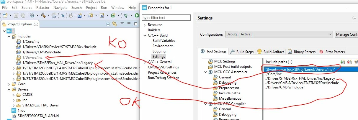

Hi I have encountered ​the exact same problem as you did. And I have solved the problem.
I found this can be solved by including it's .c implementation, such as:
#include <stm32746g_discovery_lcd.h>
#include <stm32746g_discovery_lcd.c>
But this is not a correct way to solve it.
The correct way is: Besides adding the folder of the header file to Includes, you have to also add the folder of .c file to linker folder.
Here is my note: https://hackmd.io/@quency/rJzJXx2UP
Hope it's helping. 8)
