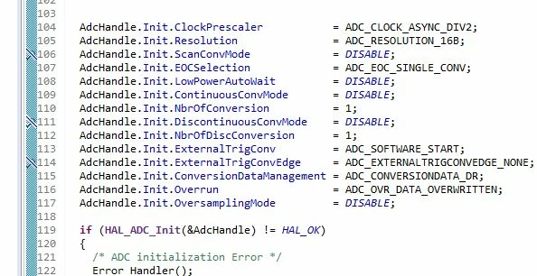

STM32CubeIDE not able to set break point?
I have convert my project to C++.
Debugging has no problem to show real time value etc. But I can't set break point as per normal, line number bar become blue line and all break point never stop.
Please advise, thanks.

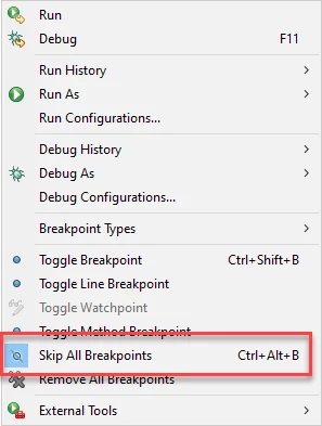

Could you explain , how you solved?
Rkord.1
Visitor II
October 12, 2021
Its late but in case anyone wonders ...
Use menu "Run" and deselect option "Skip All Breakpoints"
