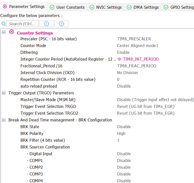

The first sign of trouble is that the period/ARR parameter gets marked as invalid with a red X:

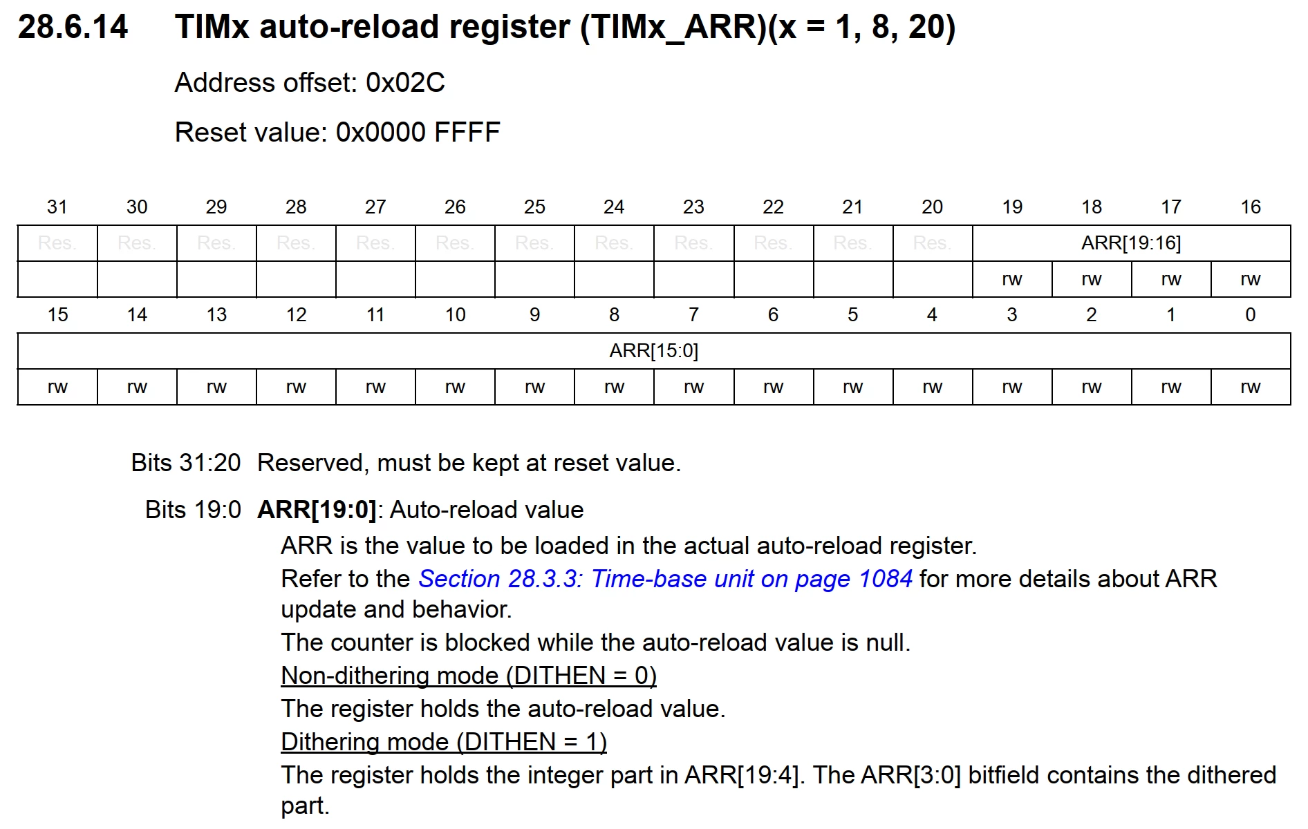

Evidently, the software believes that this register is supposed to be limited to 12 bits, but this is not correct, as shown by the reference manual RM0440:

Everything appears to work OK except that STM32CubeIDE shows that error/warning about the period being larger than 0x0FFF. Why does the configuration software limit this value to 12 bits? Shouldn't it still be 16?

    Indeed, this is a misbehavior from CubeMX tool. The ARR register size should be in line with the Ref manual content.
    As a temporary solution, you can change the value manually after the code generation.

    I logged in to report the same issue and found this thread. I'm still using CubeIDE 1.14.1 (with STM32G4 pack), so this issue has been there for a while. There are several problems:
    1. In the CubeMX GUI "Fractional" is incorrectly spelled as "Fractionnal".
    2. The CubeMX GUI misrepresents the way dithering mode works. It provides fields that when dithering is ON, the ARR register's bits are split into 12 bits of "Integer" and 4 bits of "fractional" components. In fact, the ARR register is expanded with extra bits to become 20 bits, only the semantics of the 4 lower bits are different (hence the dithering).
    3. The code generated is nonsensical:
    htim3.Init.Period = INTEGER_VALUE;
    if (HAL_TIM_Base_Init(&htim3) != HAL_OK)
    HAL_TIMEx_DitheringEnable(&htim3);
    /* rewrite ARR register when dither mode active */
    __HAL_TIM_SET_AUTORELOAD(&htim3, FRACTIONAL_VALUE);
    HAL_TIM_Base_Init is first called and sets the AUTORELOAD register to the integer value, then the
    this register is overwritten with the (ostensibly wrong) Fractional value.
    I understand your code generator might do things this way to simplify the templates, but combined with the misleading UI this becomes a complete hodgepodge (mess).
    I can offer a better workaround than what Semer suggested. In the CubeMX UI:
    1. Set the "Integer Counter Period" field to 0. it is effectively ignored by the generated code.
    2. Turn on "Disable checking" for the "Fractional Period" field, and set it to the proper 20-bit value you've chosen for
    the dithered AUTORELOAD value. Additionally, I've made a habit of placing defined names into such fields (possible, when you disable checking). For example "MY_AUTORELOAD_VALUE1". and then simply defining those values at the top of my source file. This way, you don't have to regenerate the code in order to tweak some register value.
    Semmer, Is there an update on internal ticket 169221?
