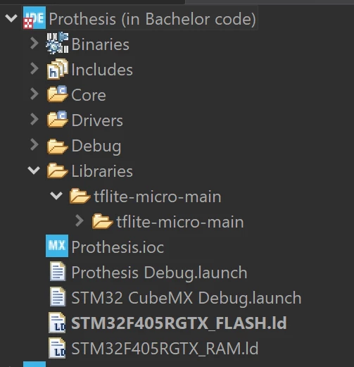

I have made a folder for the library in my project as shown:

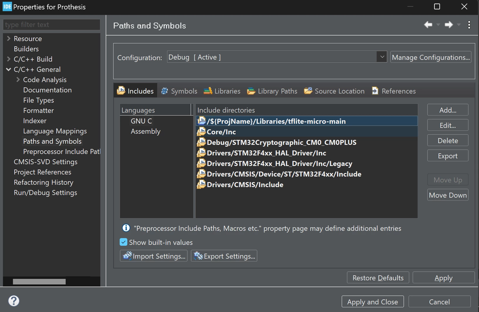

I have included the directory for the folder in under the "Path and Symbols" tab:

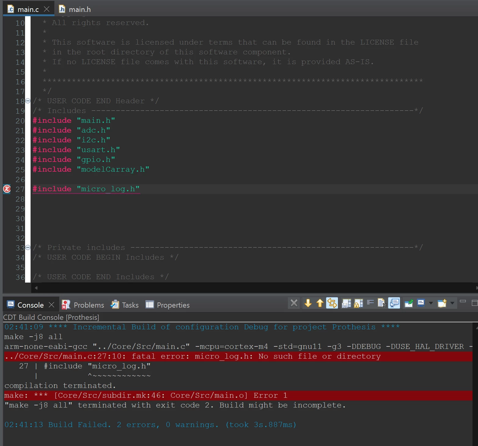

When I simply try to include one of the header files in the Core/main.c code I receive this message:

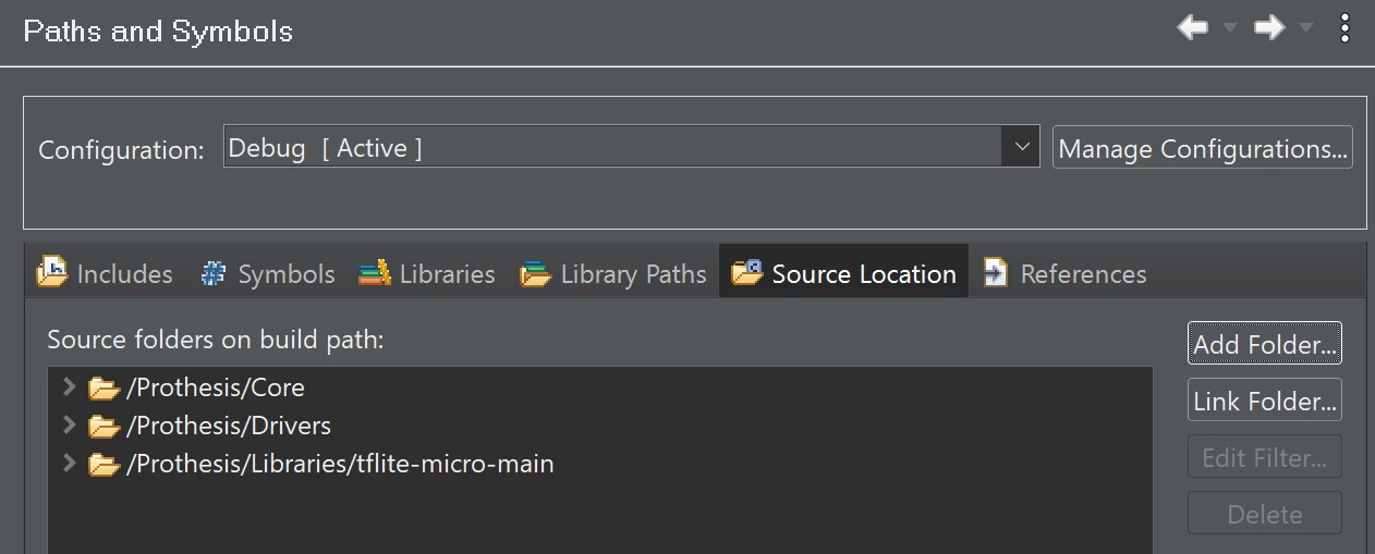

When I then also try to adding the Source Location:

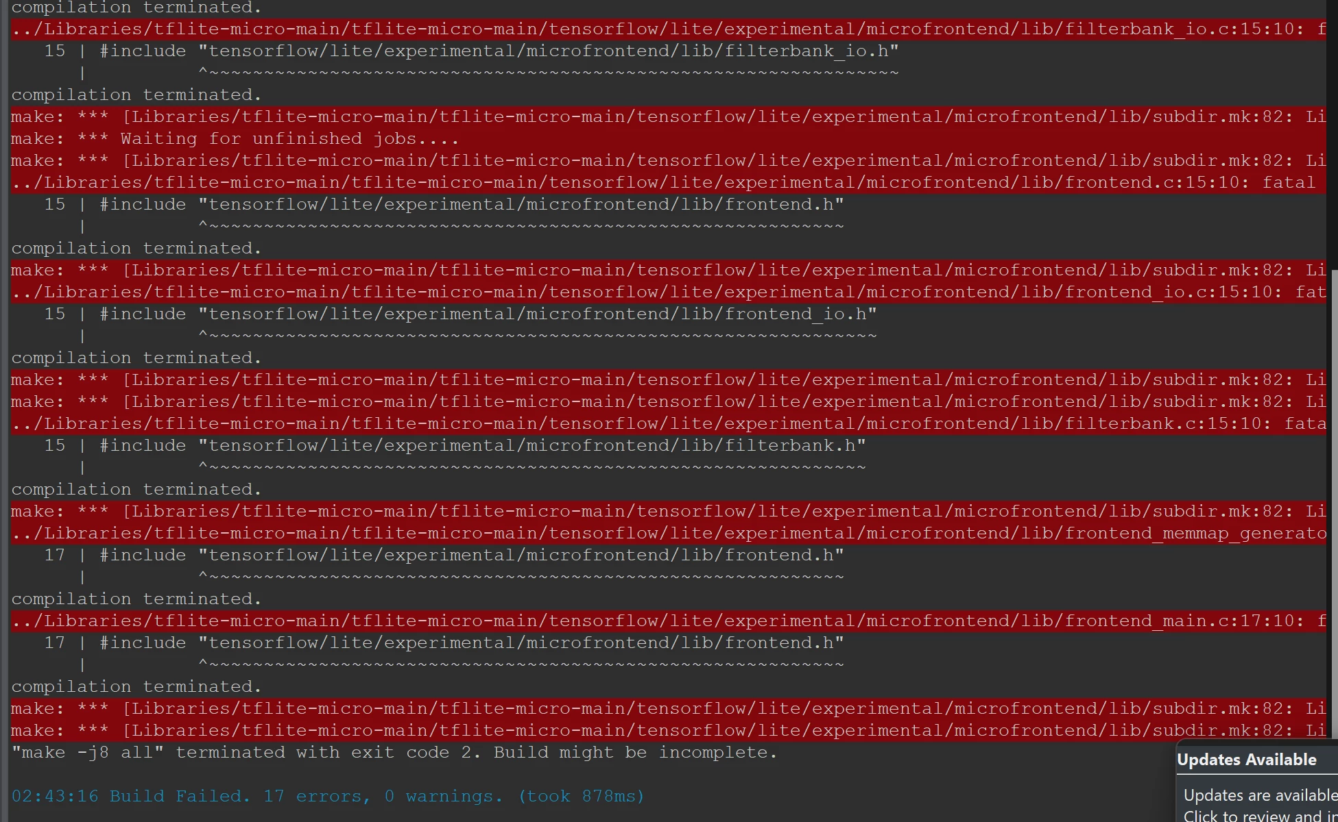

I recieve even more errors. Where most of the errors are: "No such file or directory". See image:

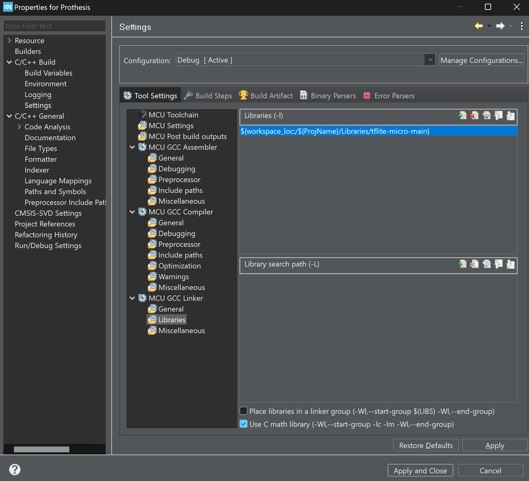

I have also trying the folder location in the C/C++ Build settings under MCU GCC Linker/Libraries, but with no success:

    This knowledge base article may help you link an external library to the STM32CubeIDE project. Otherwise, according to the screenshot, there is a mismatch of the included path of the library is ../libraries/tflite-micro-main, but in the IDE project under ../libraries/tflite-micro-main/tflite-micro-main.
    Hope this helps you!
