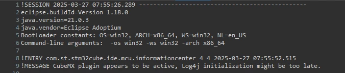

I was using STM32CubeIDE version 1.16. It was crashing occasionally. Then I wanted to update to version 1.18. It started to crash constantly while updating. Then I cleaned the program with all its extensions and reinstalled the new version(1.18). But the problem was not solved and it keeps crashing.
I checked the form and your answers. I couldn't find any solution for this.
Below is a screenshot of the errors I receive.

Pavel A.Best answer
Mar 27, 2025 8:25 PM UTC
Which version of FortiEDR do you have? In any case this thing is managed remotely by your IT. Please report to them and they know how to investigate.

Can you supply more information? What exact operating system are you using? What do you mean by "cleaned the program"?

I am using Windows 11. I uninstalled and reinstalled STM32CubeIde. I tried the last 3 versions, but in all of them the program suddenly closes after a while.

Do you have a virus scanner running? Do you have any background programs running? Do you have other programs that crash or is this the only program that gives issues?
I assume you have restarted windows.
