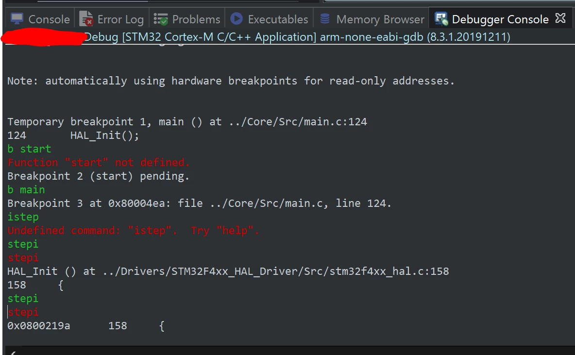

I wonder whether STM32CubeIDE allows for entering a command like
b start
set a breakpoint at "start". Sometimes it is tedious to scroll through the source to find the symbol or location to set the breakpoint. I admit this is easier in high level langiages like C but in my case it is assembly code.
(Maybe through a port gdb is listening to? But then again it would be a command bypassing the IDE)

You can use the Debugger Console window. It may not be immediately obvious that you can type commands in that window, but you can.

Thanks! Great to know :)
