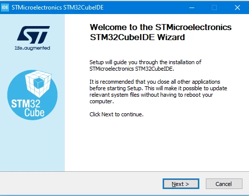

has anyone experienced similar issue when installing STM32CubeIDE?
I am downloading STM32CubeIDE from ST official here , unzipping and double-clicking received exe file (in this particular case st-stm32cubeide_1.13.2_18220_20230914_1601_x86_64.exe)
I am starting installation with admin rights and see:
but it gets stuck here:
it simply disappears after few seconds and I can do nothing ;(
I have tried also with other version and the same result.
Basically I had previously STM32CubeIDE 1.8.0 and worked fine, but uninstalled to update to the newest version. And problems started.
Any hints what to check, where to check?

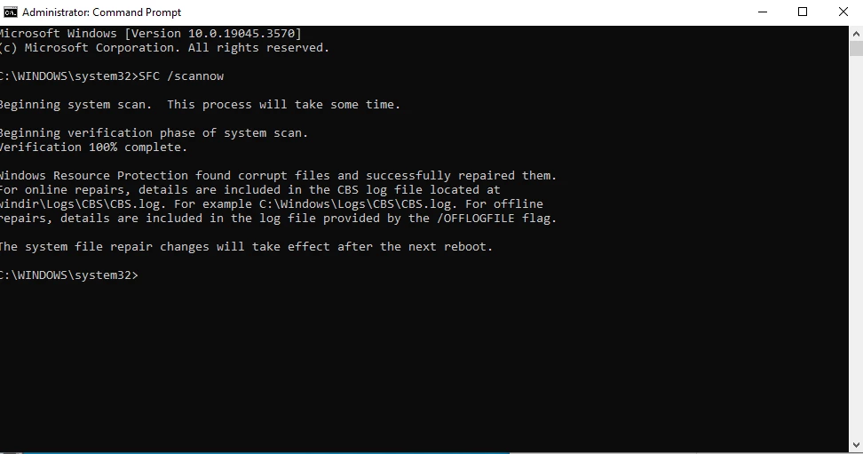

    seems I have been able to fix this with running CMD with Admin rights and typing command
    SFC /scannow
    This is Windows tool to repair when some Windows functions do not work.
    I have got summary after this
    Seems good so far, I was able to install STMCubeIDE 1.14.0 and CubeMX 6.10.0
    Hopefully it solves the issue finally.
    Thanks for your support!

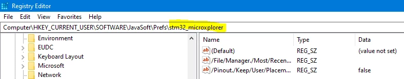

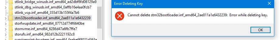

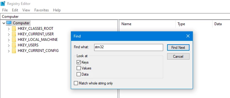

    I have double-checked registry looking for any stm32 keyword and this is as follows:
    searching conditions
    results:
    This one can not be deleted:
    Any further hints?
    SFC /scannow

    surprise !  no new bug .
    on my Laptop (on Win10/64 ) STMCubeIDE never could open an existing workspace a second time...so useless.
    i tried IDE version 1.8. ... 1.13.1 , all same - can generate one project, but never open again, after close ide.
    now i just tried running this SFC , as shown. after some minutes scanning : " no problems found" . ok.
    BUT:   STMCubeIDE now starting ! in every workspace... unbelievable !!!
    Thanks !!!
