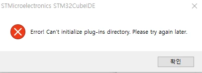

STM32CUBEIDE install error
It doesn't install as the phrase pops up. "can't initialize plugins directory. please try again later​"
I've tried everything. Please help me.

I've also searched around and come to the same conclusion as @KnarfB​ in that it appears to be a common windows issue.
The three solutions I've seen throughout these searches that has worked for some of the users are:
  1. Create a new user without any spaces or non-ASCII characters. This seems to only be relevant if your current user profile uses non-ASCII or spaces!
  2. Clean boot as described on Windows support page here.
  3. %TEMP% folder access rights, which has already been mentioned and tried.
Besides those three I haven't seen any other solutions where users reported that it worked except one where it just suddenly started working again but the user didn't mention any changes made, so not much to be learned from that case.

No specific tip, on many machines it works.
Take care that the install path is short and ASCII alphanumeric characters only, e.g. C:\ST\STM32CubeIDE.
Also: search the internet for the error message. Looks like a common windows issue.

Sometimes, issues with the access rights of the Windows %TEMP% folder were reported.
