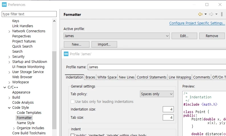

Formatter > Indentation
Tab Policy : Spaces Only
Indentation Size : 4
Tab Size : 4

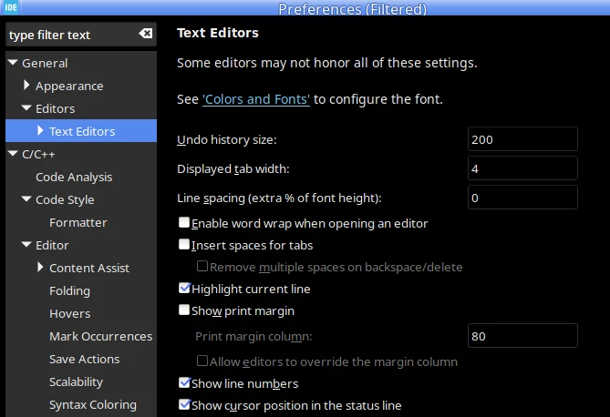

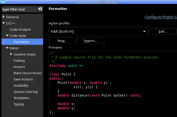

what you set in (right click in text area )-> preferences ?
I have :
and in text editors ->
--> makes 4 char indentation ->

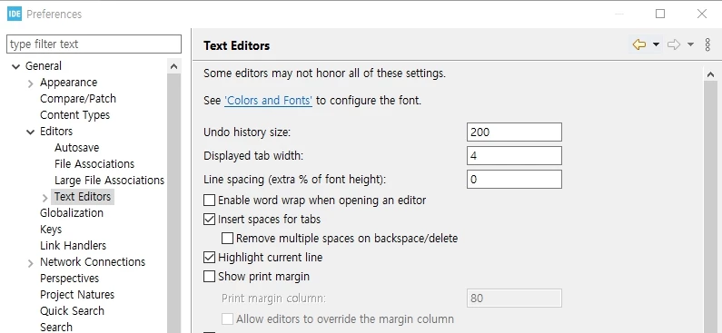

April 29, 2024
Thank you for your reply.
I still have the problem.
The code is always generated 2 characters indentation except user code.

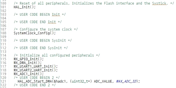

The CubeIDE generator creates that "user code" is 4-chars indentation based on settings,
but "non-user code" is 2-chars indentation automatically.
The indentation is mixed between 2 or 4 chars in one file, it makes difficult to see.
I want that both "user code" and "non-user code" are generated together
with N-chars indentation according to user's settings.

I understand what you are saying.
The "user code" (my code) can be adjusted the indentation according to my settings.
But how to adjust the indentation of "non-user code".
The indentation of "non-user code" is always 2 chars as default.
