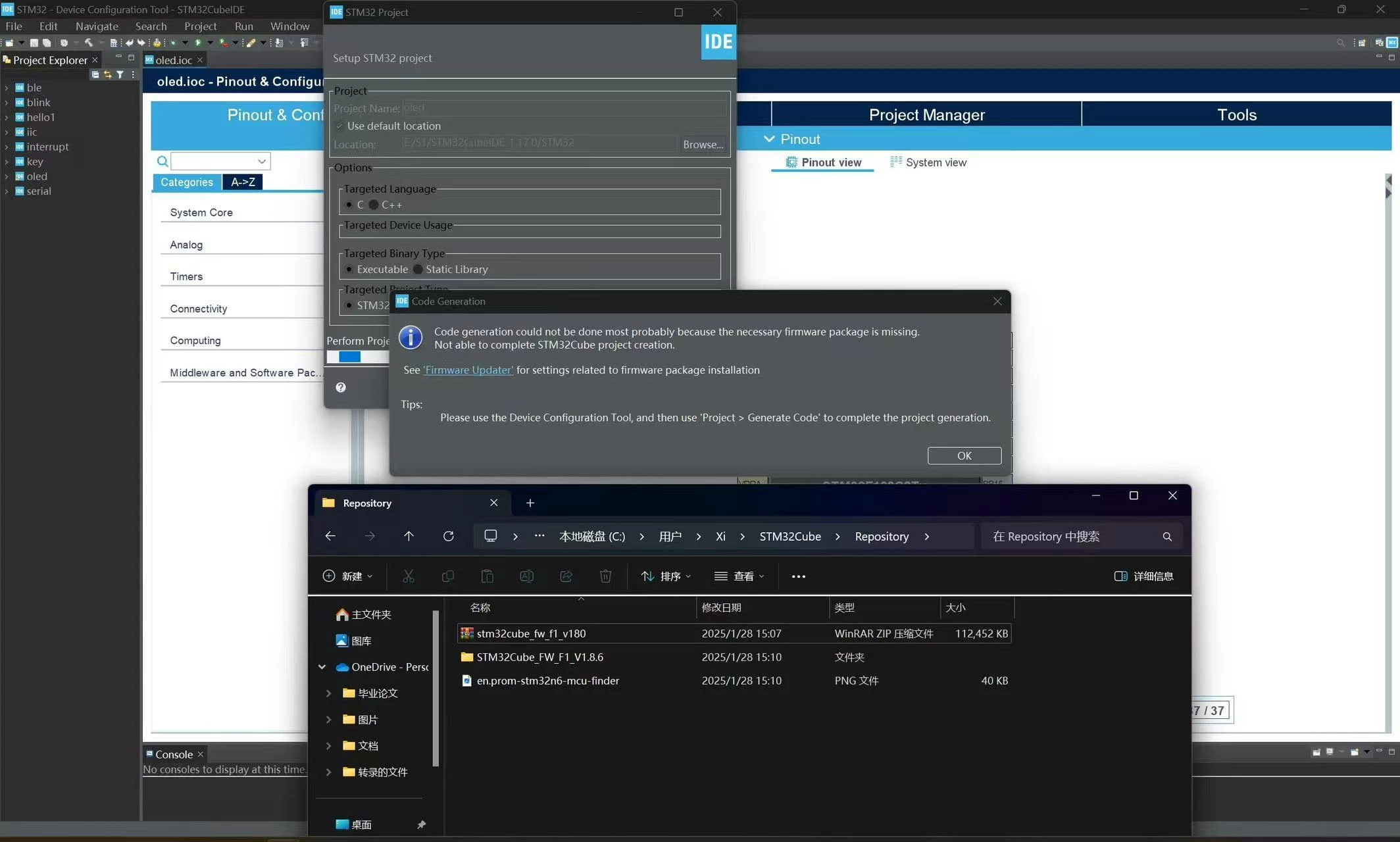

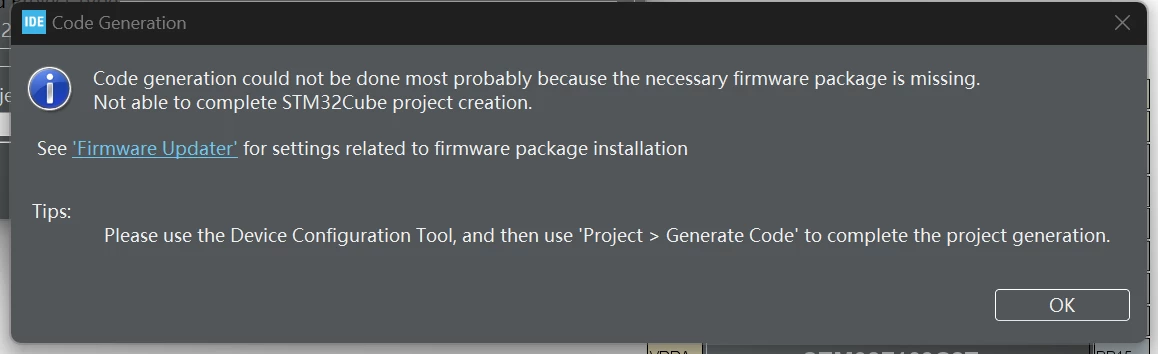

STM32CubeIDE: Impossible to generate code

The problem is most likely due to the non-ASCII characters you are using in the path.
To test and confirm this, you do not need to reinstall the firmware, but can:
  1. move the folder STM32Cube (containing Repository) to the root directory of C:
  2. and adjust the path in CubeIDE
Hope that helps?

xjmxjcAuthor
Jan 30, 2025 8:01 AM UTC
Dear Peter:
Thank you for your assistance. I followed your advice, but unfortunately, it didn't help me. I would appreciate it if you could provide alternative solutions.
Sincere thanks.

In which path did you install the IDE?
xjmxjcAuthor
Jan 30, 2025 10:06 AM UTC
I first downloaded the IDE from the official website(st.com) on January 16th, and was able to use it normally for study and writing purposes within the following week.
E:ST/STM32CubeIDE_1.17.0

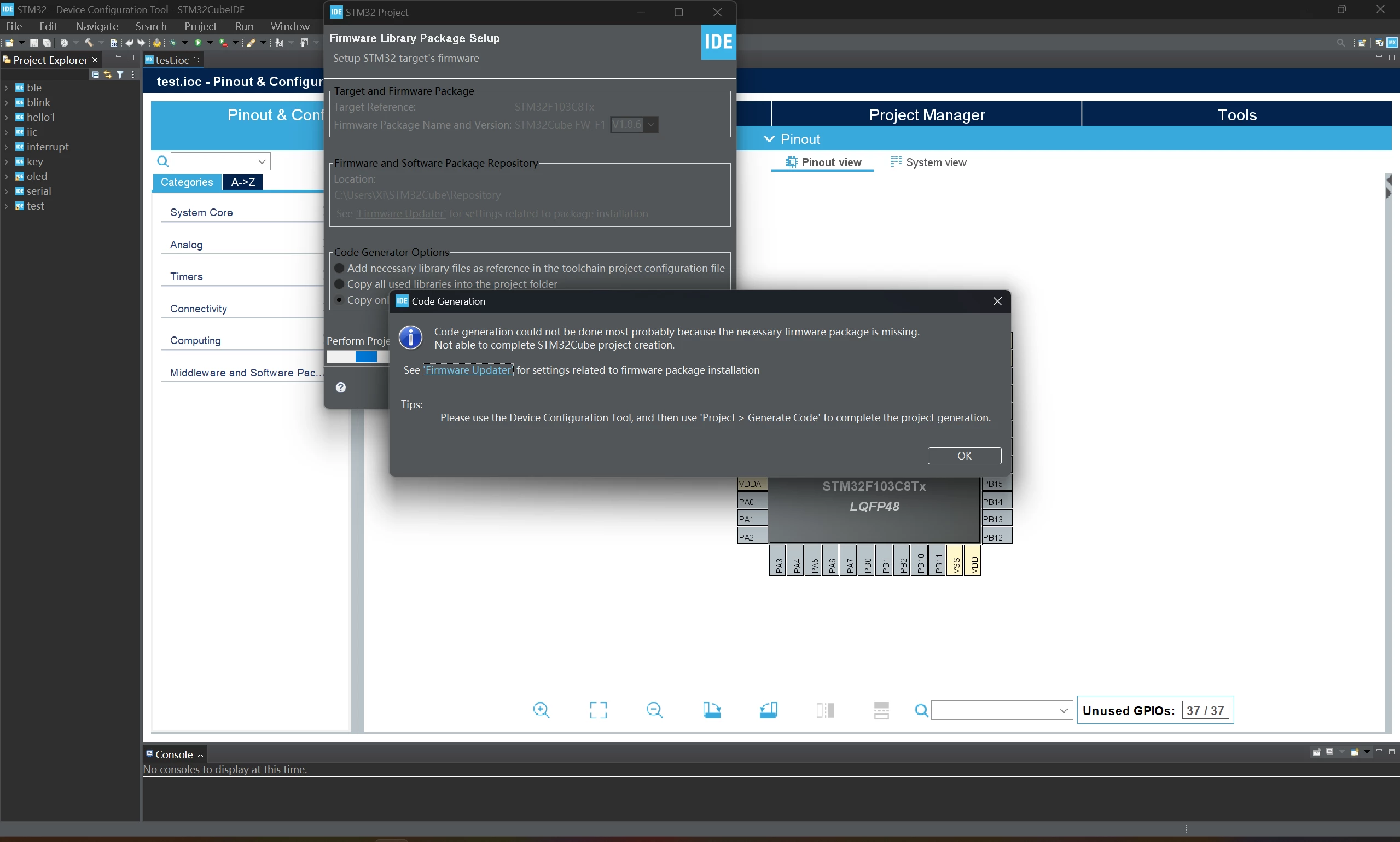

So you were able to work with it after the installation?
With which MCU was that and with which firmware library?
You can also download the firmware library a second time, unpack it manually into a different directory (slightly different directory name) and make a binary directory comparison with a suitable tool. Alternatively, change the path to that new directory as a test and try again with the CubeIDE.
xjmxjcAuthor
Feb 1, 2025 4:41 AM UTC
I apologize for taking such a long time to respond to you. Since the issue arose, I have tried numerous methods, such as clearing the CubeMX cache and restarting, checking that the MCU model and firmware version of the project match, manually specifying the firmware package path, verifying filesystem permissions, manually downloading and importing the firmware package, and reinstalling the software. I am using an STM32F103C8T6 with the firmware library STM32Cube_FW_F1_V1.8.6. Thank you for your continuous assistance and suggestions; I will keep waiting for your reply.
