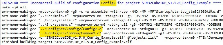

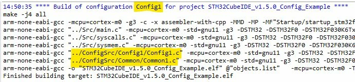

Can I ask this question again please? I've been using STM32CubeIDE v1.5.0 for a few weeks now with no problems but suddenly the build configurations are no longer showing the correct decorator icons. I've attached a sample minimum project that shows this problem on two different Windows 10 PCs running STM32CubeIDE v1.5.0. The project has two build configurations called "Config1" and "Config2":
0693W000006FpnIQAS.jpgThe project explorer looks like this when configuration Config1 is selected. The box highlights a source folder that contains excluded resources:
Here's the build output for Config1 showing the resources are correctly excluded:
0693W000006Fpw0QAC.jpgHere's the build output for Config2 showing the resources are correctly excluded:
...but the project explorer view hasn't changed. It's still showing the excluded resources for Config1 when I expect to see the excluded resources for Config2. I hope someone can repeat this from the attached project and let me know if I'm configuring the project wrong or if there's a problem with STM32CubeIDE. Thanks for any help.
