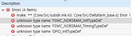

STM32CUBEIDE - I want to use the structure of the HAL driver in the newly created C file.
In the C file I made , there is an error when compiling HAL Driver HAL GPIO header and LL FSMC header in GPIOInitTypeDef structure
If I include HAL_GPIO header and LL_FSMC header in my C file, both error occur

How can I solve this problem?

Include stm32xxxx_hal.h (or main.h)
