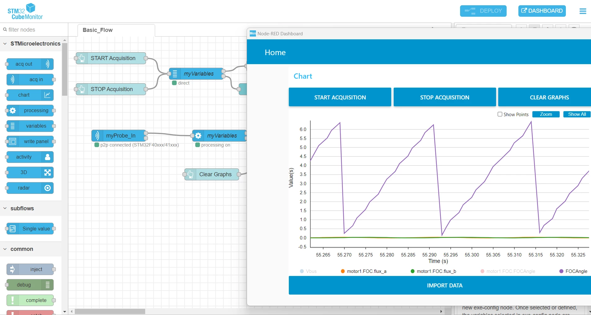

DMolo
December 31, 2022

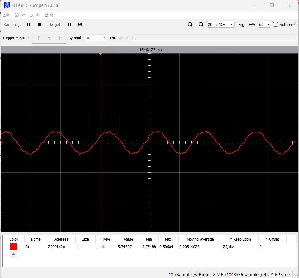

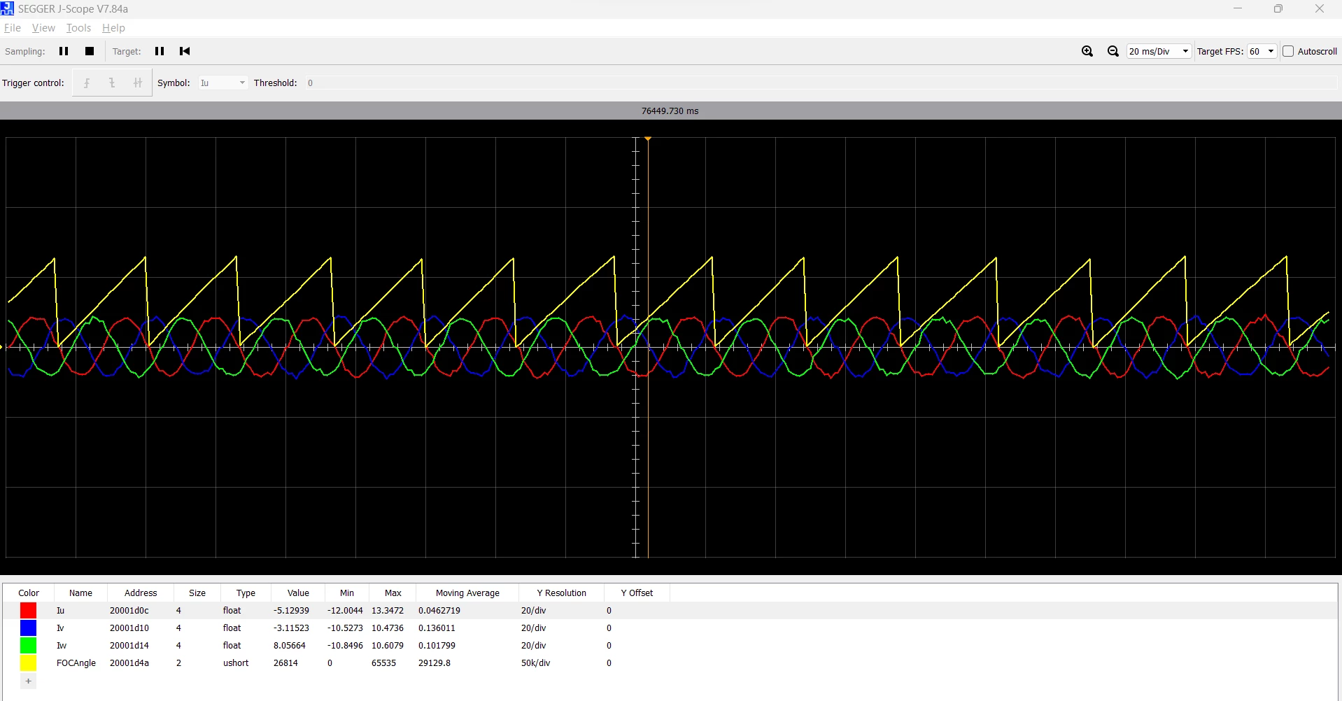

Thanks AScha.3! Core is 168MHz. I swapped to that and it immediately started working... badly. I had assumed this 8MHz value was to do with the debugger itself, not the core clock of my mcu, since it was greyed out and auto populated. Changed it in the debug config and started to get data out of it but with all sorts of glitches, and the interface simply cannot handle the amount of data it gets sent...
It also seems to be tripping the BRK, or perhaps the clock fault on the timer. MOE keeps tripping to zero, which never happens when SWV is not being used.
However, somehow this made the Segger j-scope work where it did not before (presumably embedded in the elf file or segger settings somewhere) which works pretty nicely. No MOE tripping there. I now have a nice functional scope.0693W00000Y79uNQAR.png0693W00000Y79uXQAR.png

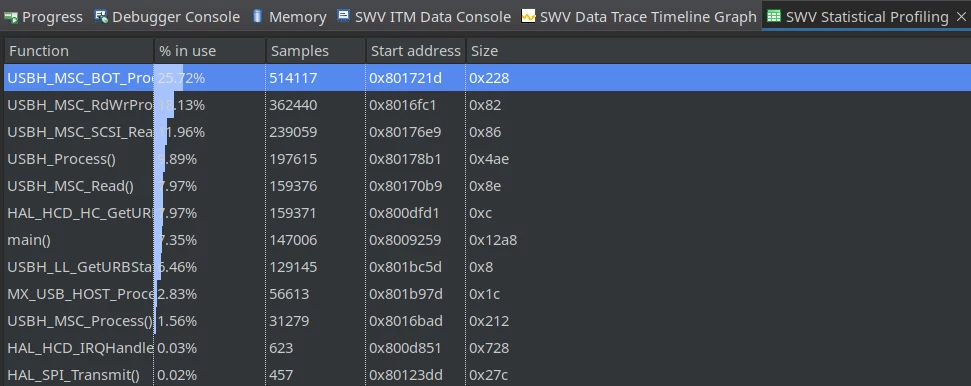

AScha.3
December 31, 2022
cool !
my new stlink V3 (mods) running now with SWV !
statistic profiling :
0693W00000Y7A48QAF.png+ Happy New Year !
DMolo
December 31, 2022
Bit more investigation and it seems there is a Cube Monitor tool now that is available, and works just fine. Guessing ST gave up bugfixing SW viewer on CubeIDE.

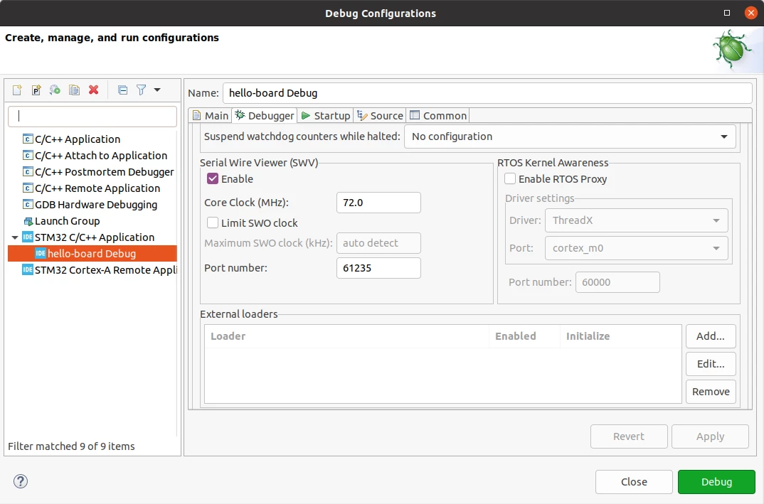

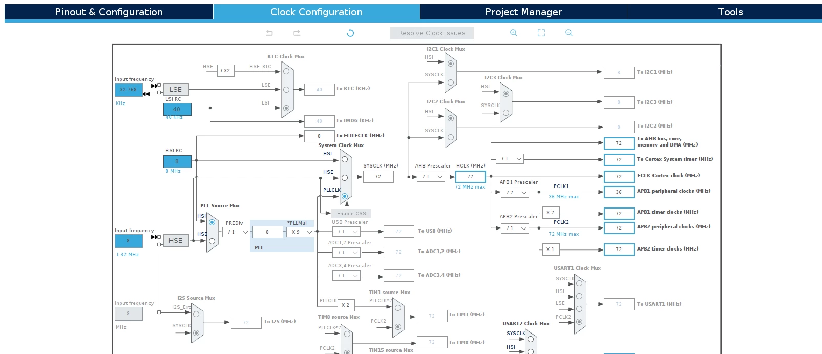

Visitor II
January 18, 2023

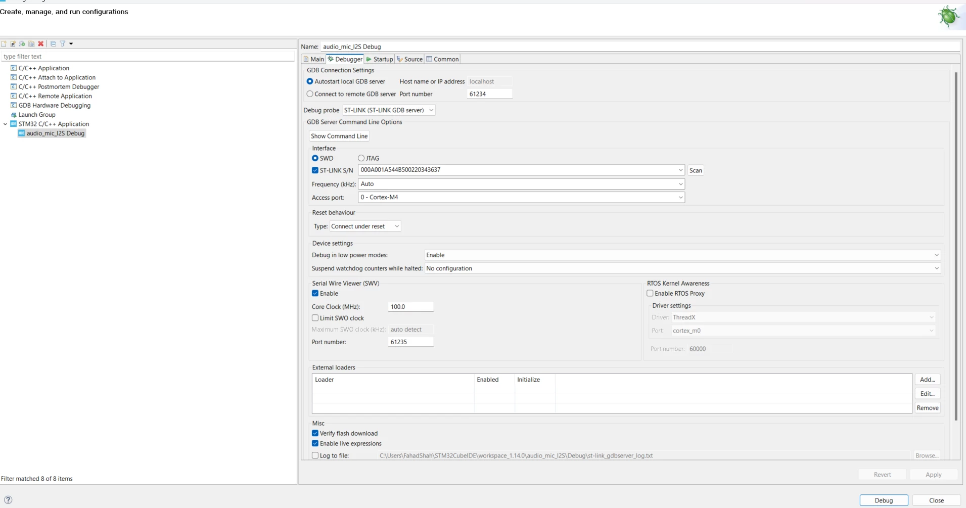

[SOLVED] Hi, if someone is facing the same issue probably you need to make sure that the clock frequency set in debug configuration is the same as your HCLK. For me it was 72 MHZ. See figures.0693W00000Y8ZHiQAN.png0693W00000Y8ZHYQA3.png

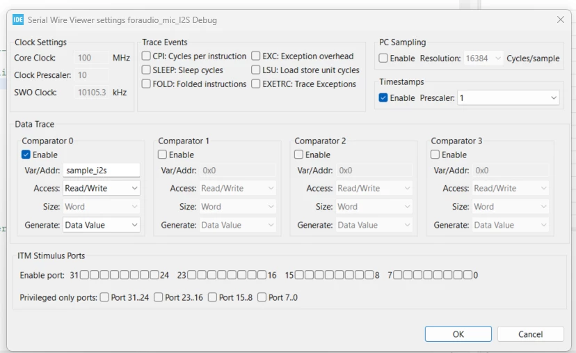

May 16, 2024

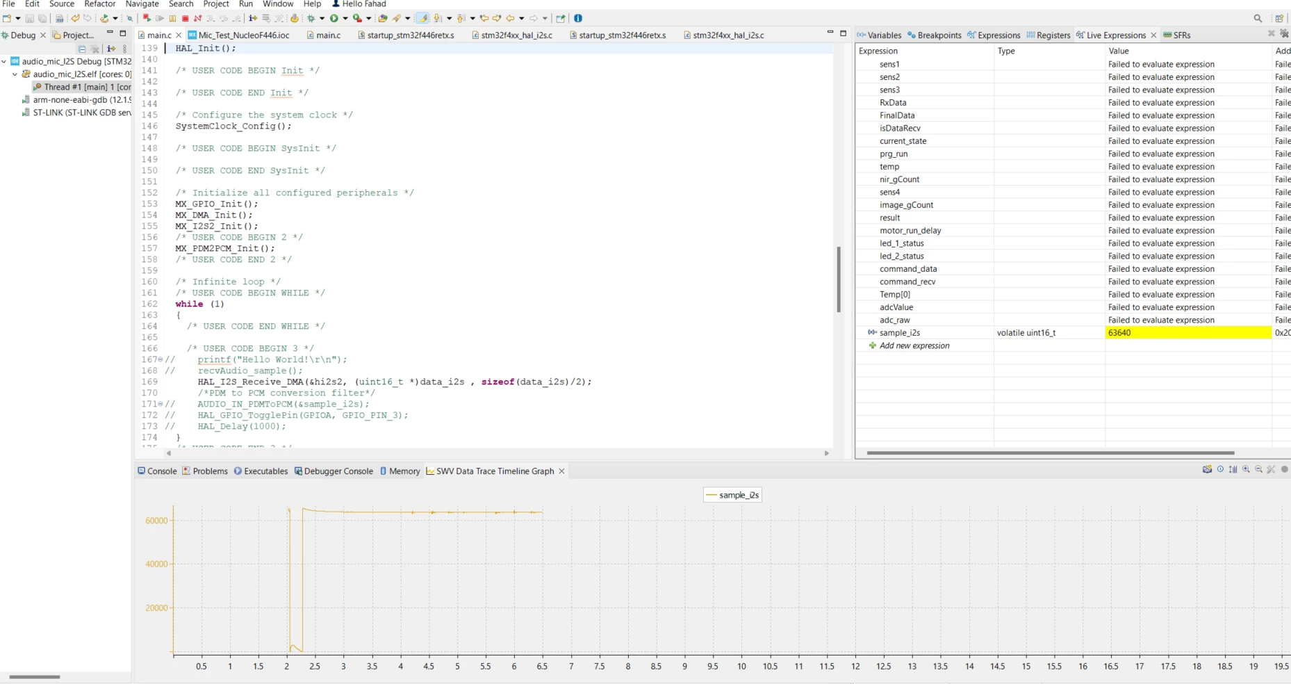

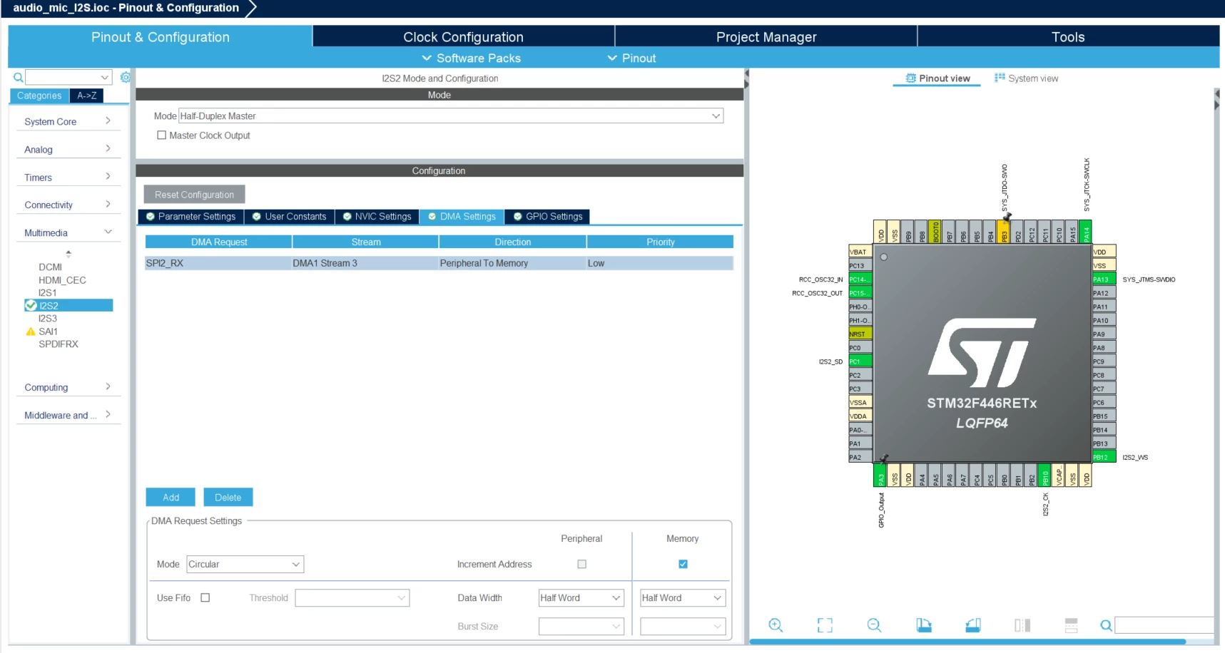

I am trying to use the SWV Timeline Graph, but I am unable to run it for more than 4 to 6 seconds. Could you please provide some advice on this? I am attaching all the screenshots. I am using I2S communication to interface MEMS mics SPH0645LM4H.
I have a custom board with an STM32F446RE and an ST debugger model STLINK-V3SET.
Thank you.
MCU --- Debugger
Gnd --- Vcc
Clk -- Clk
Gnd -- Gnd
SWDIO -- SWDIO
NRST -- NRST
SWO---SWO
I tried same code on Nucleo-F446 an
d SWV Timeline Graph works continuously. Kindly check the screen shots and let me know if you see any issue.
