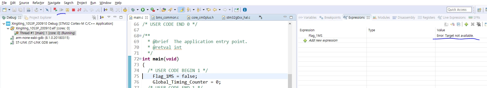

Hello, ​
I am using the STM32 Cube IDE.
I want to monitor real-time variables through debugging mode.
But it doesn't...
How use to Real-Time variables??​

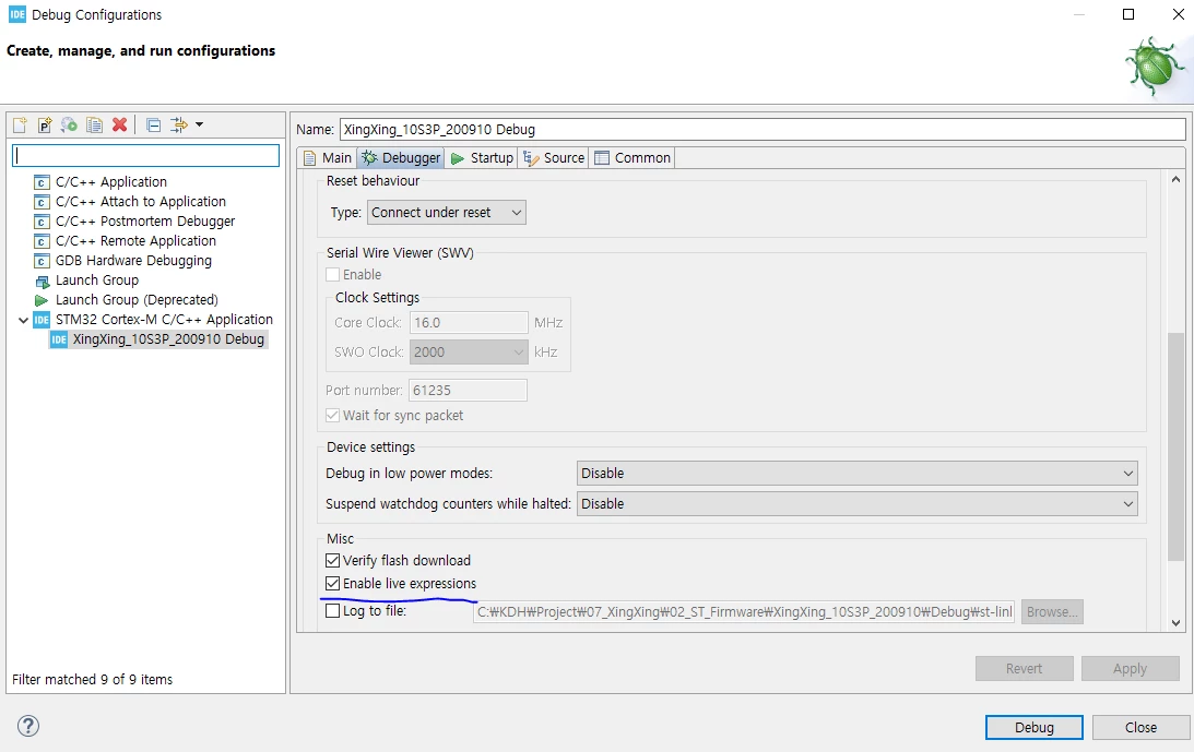

September 14, 2020
Add them on the live expressions tab. It's buggy on restarts, you usually have to re-enter them when you re-run, but it works.
September 14, 2020
The "Live Expressions" tab is two tabs to the right of the "Expressions" tab on your last screenshot.

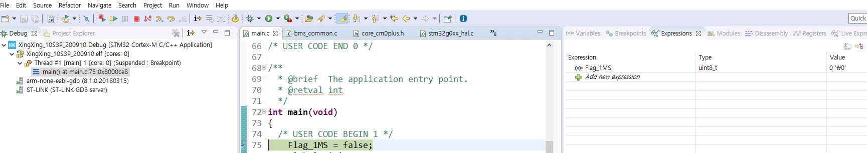

September 14, 2020
I think it's mean.
Is it right??
But It isn't real time variables...
It has a fixed value.
I toggled it every second by program.
September 14, 2020
Works for me. Make sure your variable exists and the compiler isn't optimizing it out.

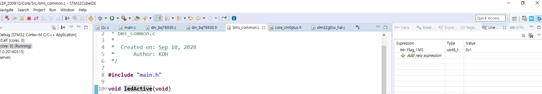

September 14, 2020
I used ST-LINK/V2.
Target mcu is STM32G030C8T.​
VDD
GND
SWCLK
SWDIO
Debug Setting.
I programmed the variable to increase by 1 every second.
However, after changing from the initial value 0 to 1, nothing has changed.

September 14, 2020
Maybe the G0 doesn't support live expressions. I don't have a board to test it with. Not sure.
