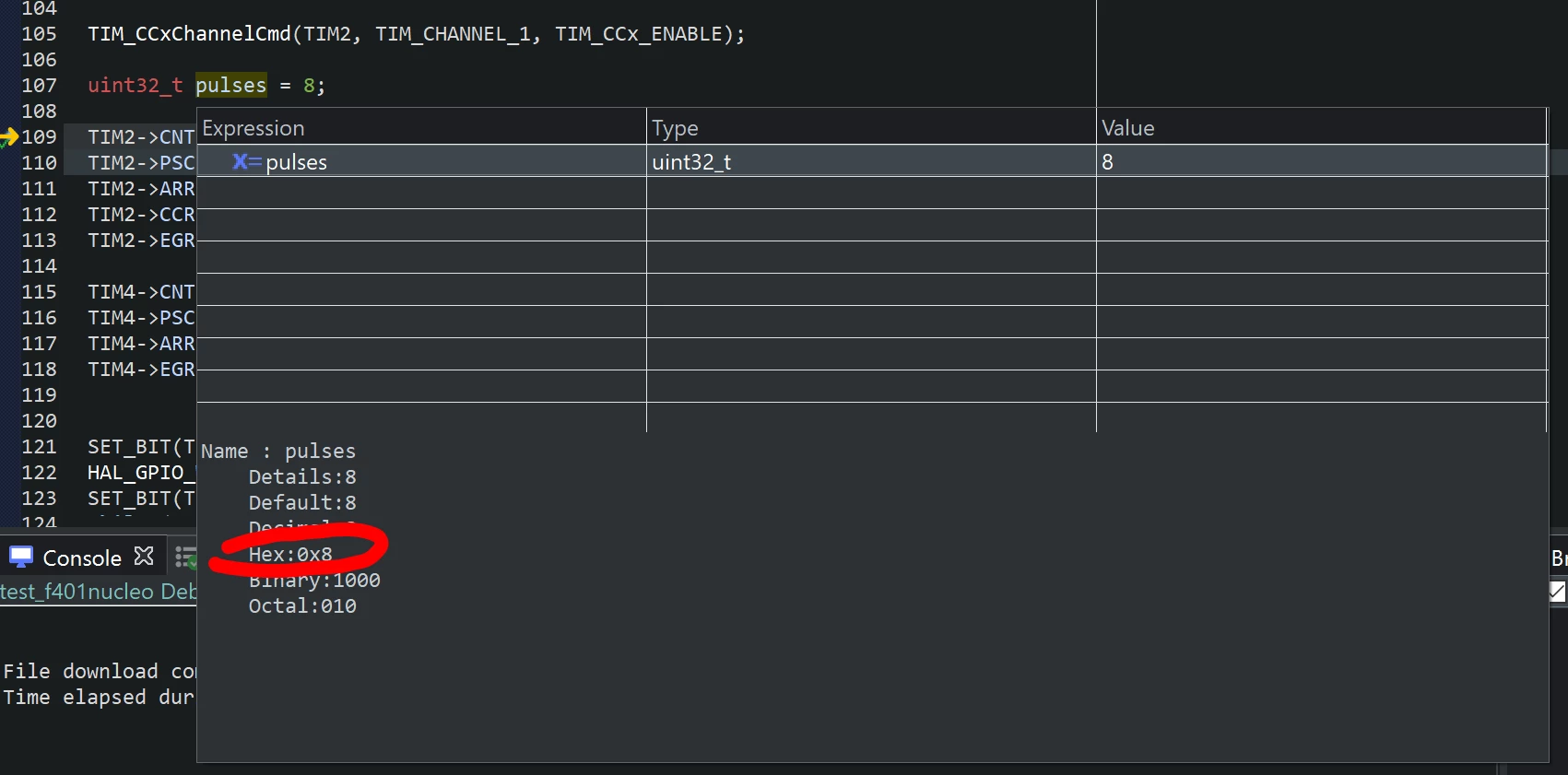

It displays the value in hex at the bottom of the expression window, along with binary and octal.

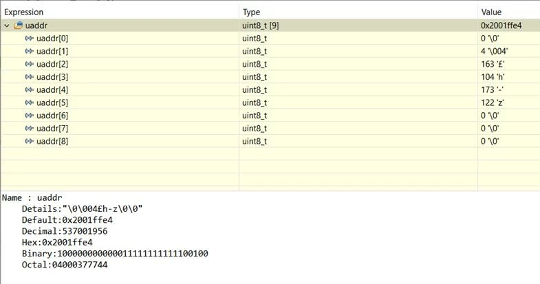

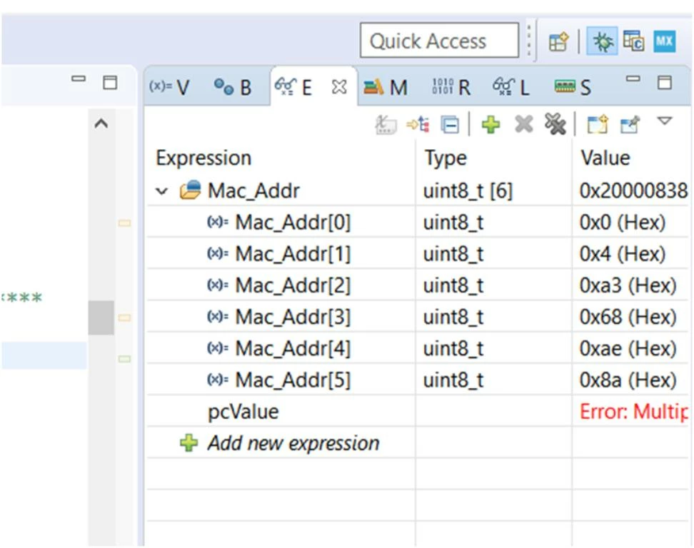

TDK, that works fine for a single variable. But it is useless for an array. I have several uint8_t arrays. The individual elements of the array in the Value column of the Expression window display as decimal values. The Hex display doesn't show the individual elements of the array. In fact, I don't know what that number refers to.
The hex values of the attached screen shot are 0x00, 0x04, 0xA3, 0x68, 0xAD, 0x7A. That is what I would like the Value column to display.
Sorry for the image size. I don't know how to make the image larger.

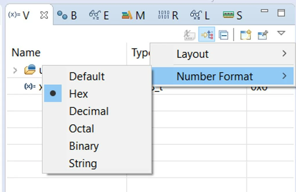

Jul 12, 2020 12:10 AM UTC
Pick hex format as the default number format for variables.
After that, values in hover will be displayed in hex by default.

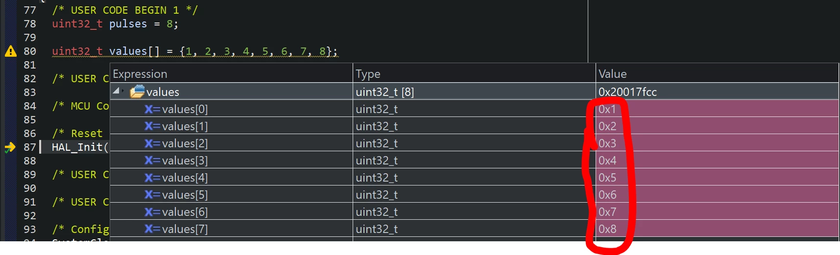

Further testing reveals changing number format to hex does work if..............
I change the number format to hex but when I hover over the variable in the Expression window, it continues to display in decimal. HOWEVER, if I close STM32cubeide, restart it, and restart the debug session, now when I hover over the variable it displays the value in hex in the Expression window. I have to do this for any variable I want to display as hex. I guess that is just one of the quirks of STM32cubeide.
TDKBest answer
Jul 12, 2020 7:36 PM UTC
> Unfortunately that does not work on my system.
Don't click the tab. Click the down arrow on the top right of the variable tab to change the default number format.
Works for me. Win10 STM32CubeIDE.
Make a screenshot to show what you're doing instead. Sounds like you're not understanding.

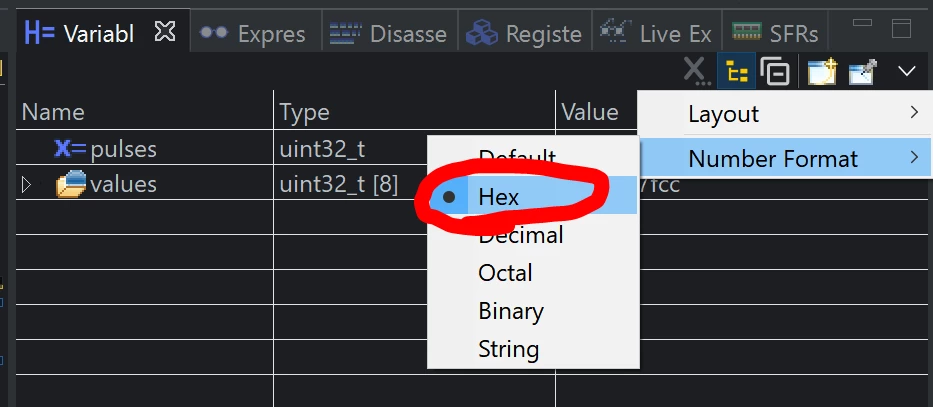

Attached is a screenshot. I don't see a down arrow on the variable tab. However, as I mentioned in my last post it does work if I set the variables to hex and restart STM32cubeide. So I guess it is working well enough for debugging purposes.0693W000001shtQQAQ.jpg
Raymond Buck
Senior
Jul 13, 2020 2:09 AM UTC
TDK, I see what you mean now. The down arrow is on the far right of the toolbar above the Value column. That works and changes the variables to hex.
