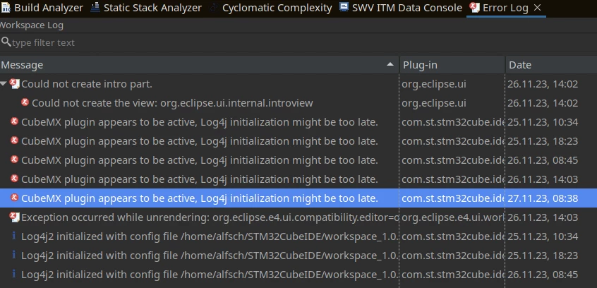

error log:
there seems to be a basic problem long time, because the "MX plugin seems to be active" (seems (!!!) is which language? Java for kiddies ?) message coming all the time, even since i always close MX view before shutdown every time, to  avoid reduce the crash events.

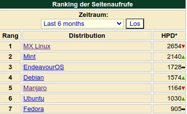

its not ubuntu...its MX.   see ranking...and ubuntu..
https://distrowatch.com/table.php?distribution=mx
