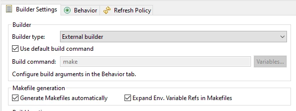

Do you use internal or external builder (Properties->C/C++ build)?
Konami
KonamiAuthor
Senior
January 4, 2023
External:
