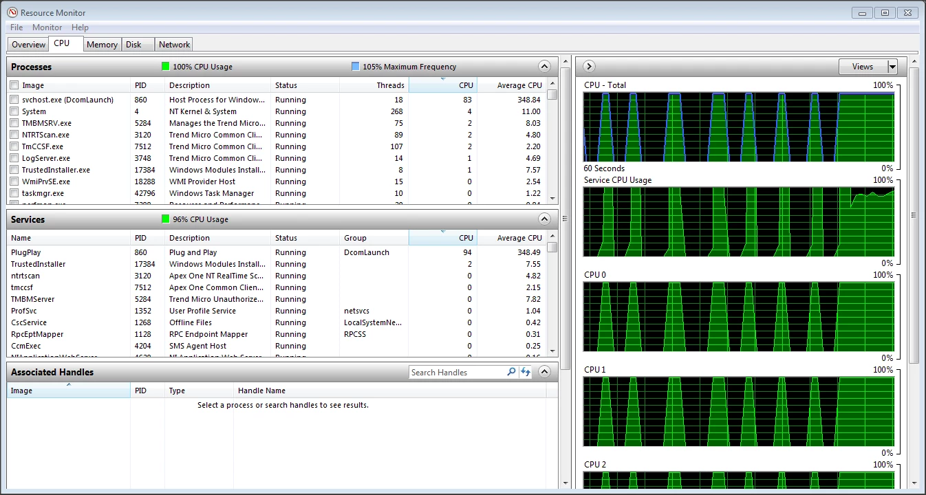

I installed STM32CubeIDE (Version: 1.1.0, Build: 4551_20191014-1140 (UTC)) on my laptop (Win7, 64bit). The installation path is "C:\tools\ST\STM32CubeIDE_1.1.0\STM32CubeIDE"
As soon as I start the IDE the CPU load on my laptop the CPU load goes up to the maximum. In the ressourcemonitor this process needs most of the CPU: svchost.exe (DcomLaunch).
And in Services the most CPU load has: PugPlay from Group DcomLaunch. Details see the screenshot.

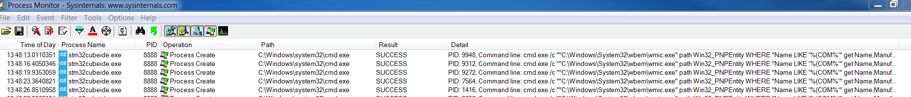

We got it to run. The solution was to change the windows display language from German to English.
My workmates analysis that the command
"C:\Windows\System32\wbem\wmic.exe" path Win32_PNPEntity WHERE "Name LIKE '%(COM%'" get Name,Manufacturer /format:rawxml
was taking around 7s (with German language). This command was called every 4s from the IDE so the CPU load arises up to 100%.
