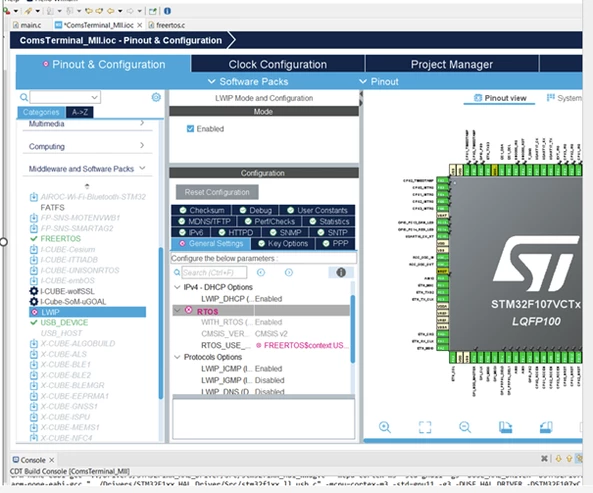

STM32CubeIDE + FreeRTOS + LWIP
Does anyone know what is causing this error and how to fix it in STMCubeIDE?
As shown, this is specific to STM32F107VCT as it may be that STM32F4 does not see this. Buildable code cannot be generated.
Thanks!

    Hello @spoatech
    Have you tried to change the value in red here :
    to 1 on the .IOC file and then regenerate the code. That should work.
    Best Regards.

    The RTOS_NEWLIB_REENTRANT (FREERTOS USE_NEWLIB_REENTRANT 1) is linked to FREERTOS API CMSIS version parameter. It should be set to 1 so a newlib reent structure will be allocated for each created task wish allow. This parameter takes 0 or 1 to eliminate the warning message. More details on the MACRO available in this link.

    March 5, 2024
    @STTwo-32
    That works after all. The code builds without errors.
