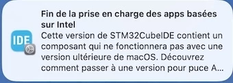

I have the latest version of STM32CubeIDE for Mac with an Apple Silicon (2.1.1).
From time to time, I get the message

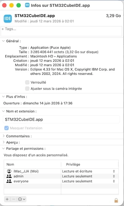

When I check the program informations, it confirms that I have the correct version (Apple Silicon).
I think the problem is caused by Eclipse (version 4.33), which is out of date.
Is there an upcoming update for STM32CubeIDE with the ARM version of Eclipse?

Hello ​@FRAUBRY
Thanks for reporting this behavior,
Actually, the STM32CubeIDE team is aware of this issue; a resolution is scheduled for the future version of STM32CubeIDE.
KR, Souhaib
