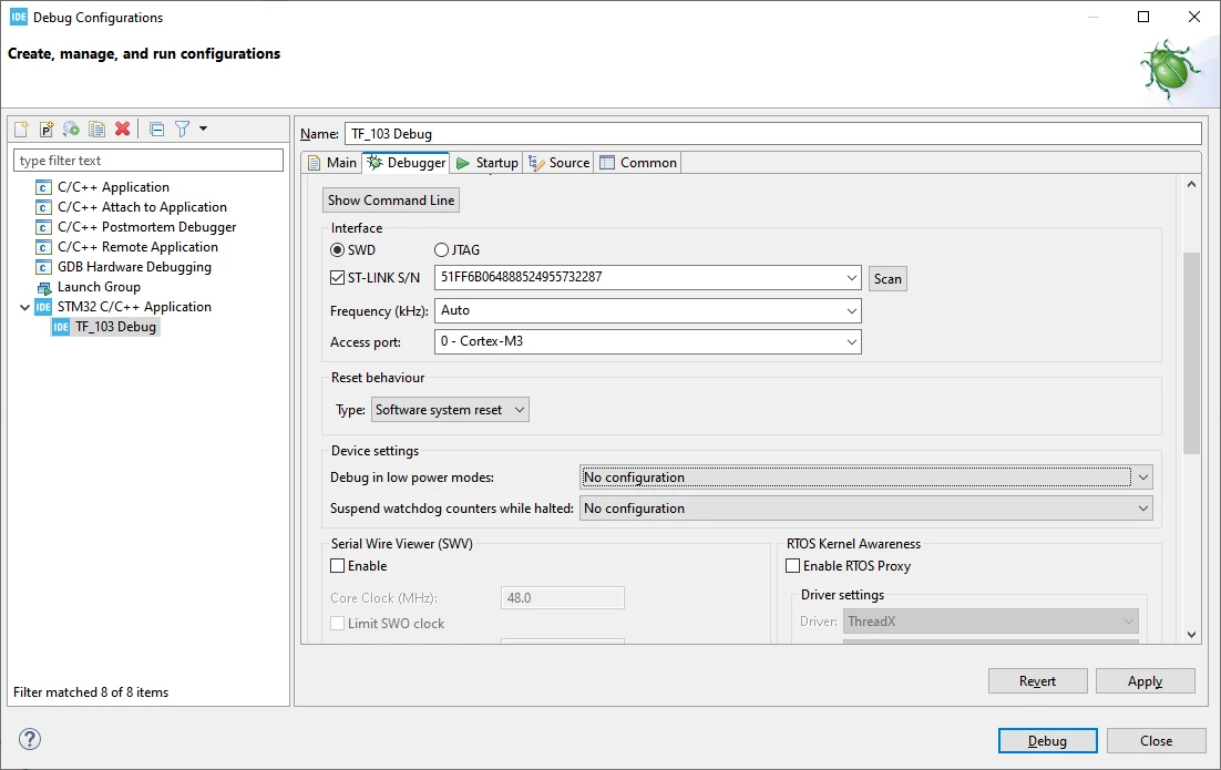

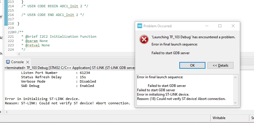

hello,
I have the same problem posted by H.Ahmed on October 2022, read also in other posts:
"Failed to start GDB Server Error Initializing ST-LINK device
Reason (18) Could not verify ST device!"
I tried all suggestions found on web, but no help.
I'm using STM32CubeIde 1.14.1,  ST-Link V2  (updated)
Connection is very simple and should be OK, because if i program the device wth ST-Link Utility
or with STM32CubeProgrammer, all works fine.
I tried with CubeIde 1.8.0 as suggested in another post, but no luck.
Even older projects who i made some years ago, now have the same problem.

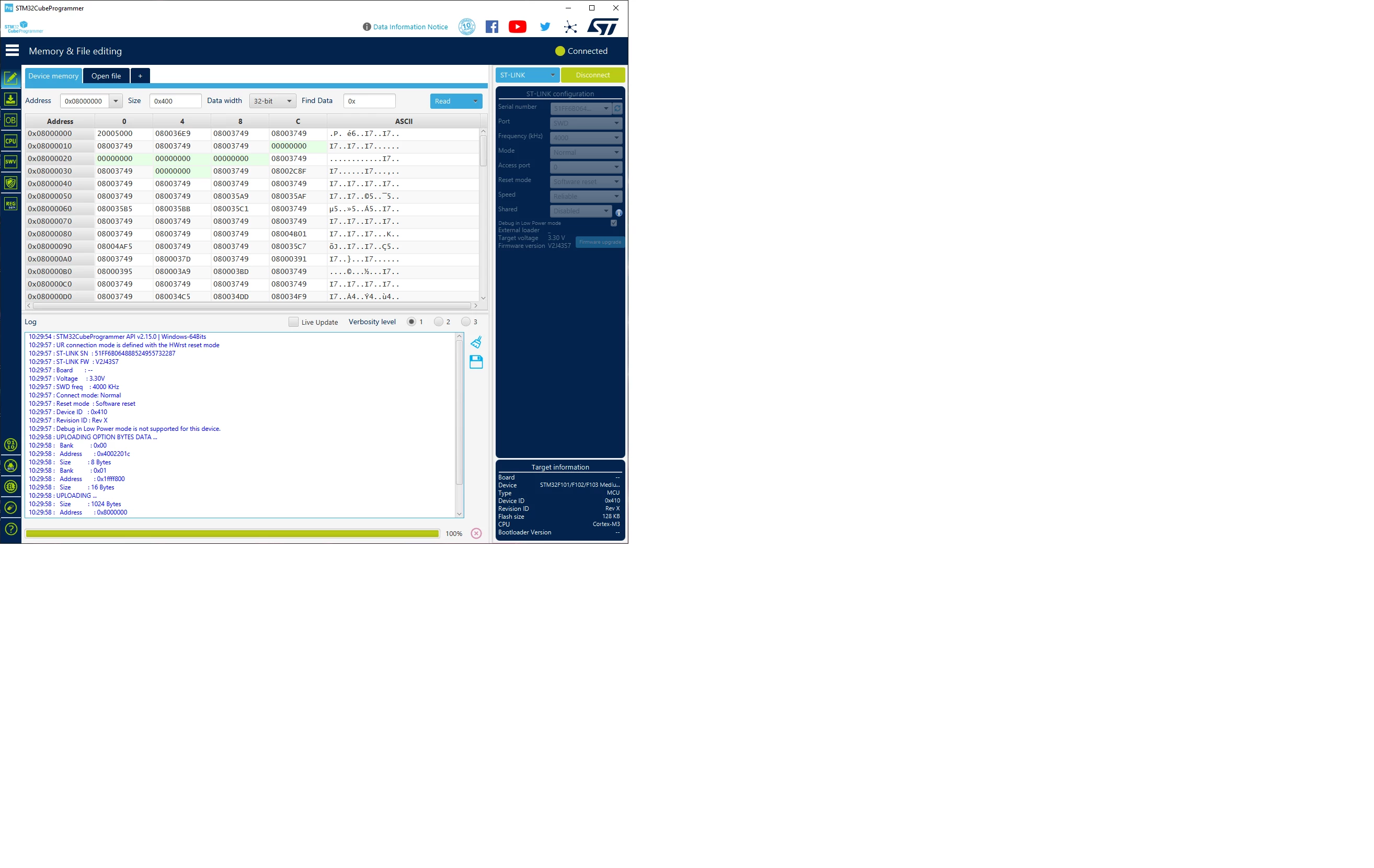

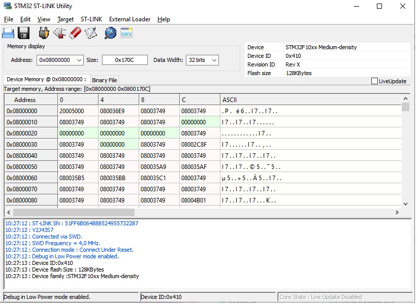

Mauri
MauriAuthor
Yes, i think so. Please see attached the screen of ST-Link Utility and Cobe Programmer.
Is there a sign of non genuine product?
Yhank You.

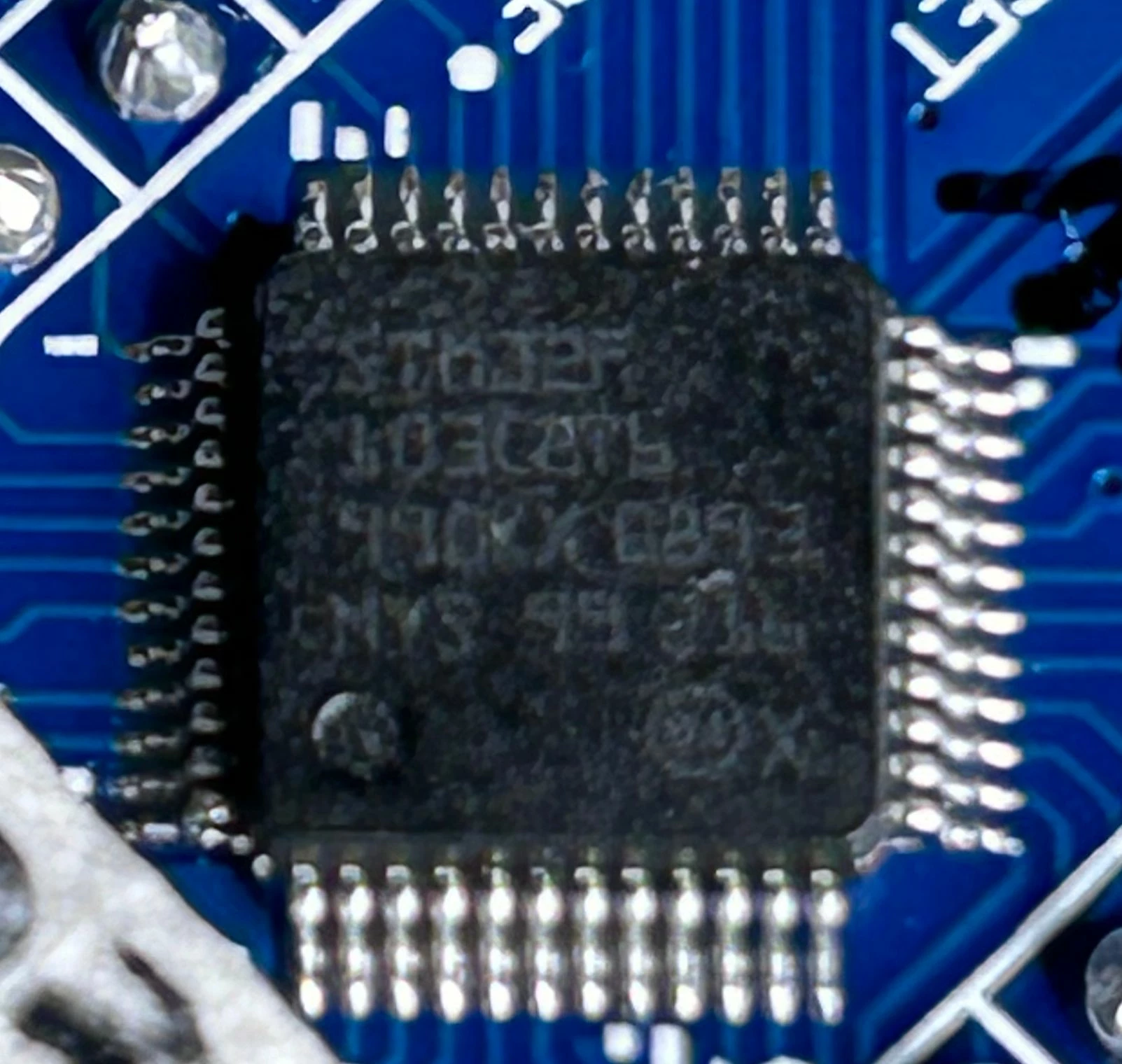

AScha.3
Yes, because IDE refuses to work with this (wrong cpu inside) st-link.
ST-link utilty (old...) + CubeProgrammer not checking (until now) original or not, so they still work.
The st-link V2 "sticks" work ok also with IDE, if there is a STM32F103 inside;
i know, because i have some of these !
But also some with a CK32F103 , here IDE tell you the story about wrong product...
So buy a new st-link V3 , or if want cheap, a st-link V2 "fake" (but verify, it has genuine stm32f103cb inside! )

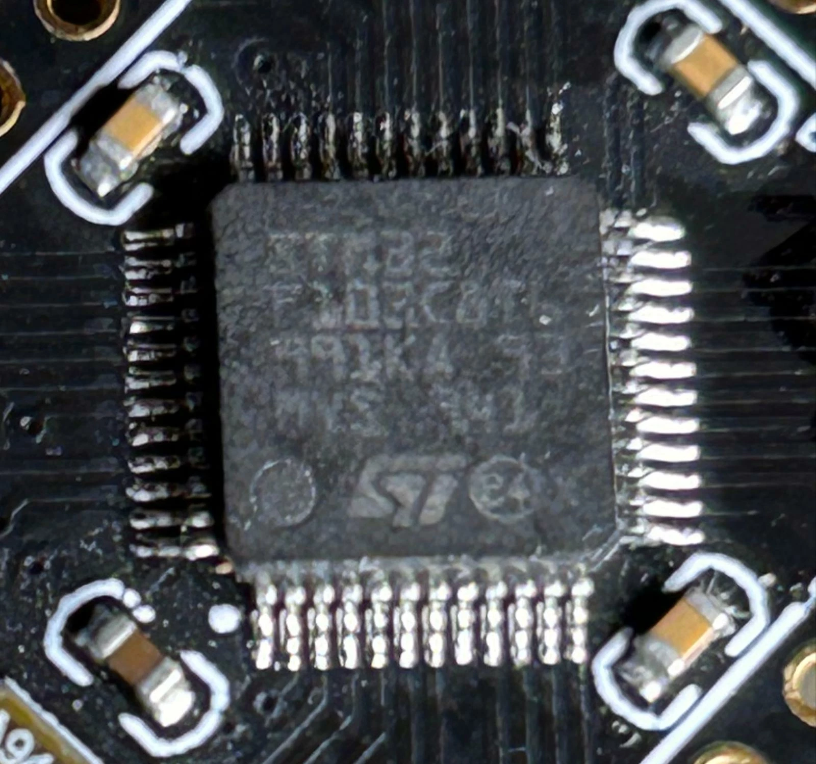

Mauri
MauriAuthor
I apologize, at the end it seems that the device is NOT genuine, even if it looks that.
I attach 2 pictures: one works, and one gives error.
Is the difference the ST LOGO on the bottom?
Thank you very much to all who replayed me
