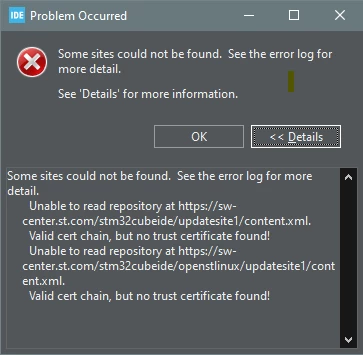

STM32CubeIDE: error when checking for updates
after installing STM32CubeIDE v1.11, I get the following error when running Help-->Check for updates
I've already tried the hints from other posts like clearing the cache, checking proxy, checking the https addresses, etc.
Other updates work, like Help-->Check for Target Selector Device Database Updates.
I've also uninstalled STM32CubeIDE completely and freshly installed v1.13 but the behavior remains.

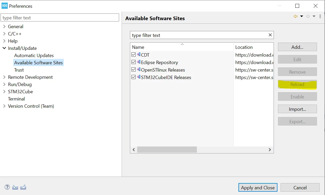

At first, could you try to check the proxy settings following these steps:
- Under Window --> Preferences--> Network Connections, activate Native provider
- Under Window --> Preferences--> Firmware Updater, click on Check Connection
don't forget Apply and Close, if the connection works.
Also, reload OpenSTLinux Releases under preferences-->available software sites, as shown in this screenshot
Thanks,
Rim.

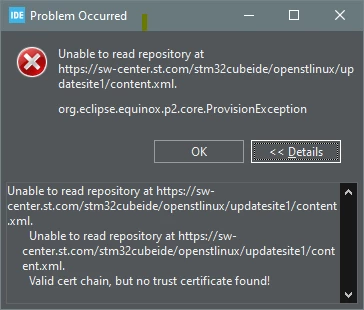

September 26, 2023
Hello Rim,
Native provider was activates but I cannot find "Window --> Preferences--> Firmware Updater, Check Connection"
Reloading OpenSTLinux Releases results in the same error message:
Thank you.
Regards, Peter
