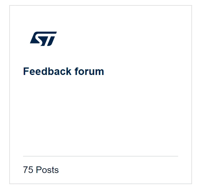

I would say you're posting in the wrong forum, but there's actually no description anywhere on what the "Feedback Forum" is for.
Historically, the feedback forum is not meant for technical questions.

Hello @TDK ,
Well noted. The description is now in place!
