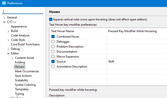

STM32CubeIDE editor hover no longer works
Editor hover no longer works on my STM32CubeIDE installation, and I have no idea why.
Hover setup is like this, which I believe should be correct. Also, I haven’t changed anything (first time seeing this menu myself).
I haven’t found a menu or anything that turns the hover feature off. Does anyone have an idea what the problem could be?
When a feature is not longer working or available, I really find out how often I use it…
Edit: Version is 2.2.0. Now checking for updates… Nope, no updates.
Using a V 2.xx IDE version ?   :)
(I use V1.18 + 1.19 versions and never had this problem.)
Did you close and restart IDE ?
If nothing helps, you could kill all IDE layout settings and bring it to installation state:
>>To do this, just remove or rename (to restore it, if needed) this file inside your workspace:
>> .metadata/.plugins/org.eclipse.e4.workbench/workbench.xmi
>> Hope this solves the issue.
>> (this file is the responsible of saving your workbench layout)
Yeah, I did.
It has worked before with this version – then, out of the blue, it just stopped working.
Thank you for your suggestions. I will try them when I have more time. Right now, I am a bit swamped.

While I was busy working on some code, and did not have time to experiment with the IDE, I accidentally clicked on a menu icon that completely messed up my workspace. This immediately put me in an “AAAARRGHHH!!! 🤯” state. But, luckily, I had saved my preferred perspective in a file years ago. I loaded that, and continued working.
Suddenly, I noticed that the “hover” feature was working again.
I still don’t know why it stopped working in the first place, or why loading the perspective fixed. The “Hovers” settings are unchanged. So, still kind of a mystery, but at least it has been solved.
