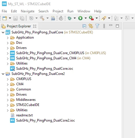

STM32CubeIDE dual core copy project Issue. Hi. The copy project function over IDE V1.8.0 and Dual Core doesn´t work properly. When you try it you get: Project xxx2 is created after copy funtion of first one. Internal Project conditions is lost.

Hello @Luisico​ and welcome to the Community :)
This is a known issue with STM32CubeIDE:
"Hierarchical projects cannot be imported with the option Copy into workspace."
For more details about the known problems and limitations, please refer to the STM32 MCU wiki at STM32CubeIDE errata 1.8.0.
