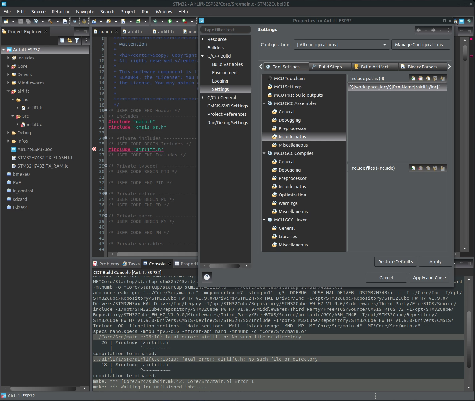

Right now the IDE is driving me crazy: I've written an include in my project, made requred/mandatory entry in project settings (see the attachement), and get the error message "No such file or directory" when I compile the project.
I've checked several times that everything is correct, can't find any errors, but I always get this error message.
As you can see in the bottom part of the screen shot, the compiler doesn't include this directory ("-I ...") in the command line.
Can someone help me please!
Thanks in advance,
Michael

Hello @Mick P. F.​ ,
As indicated by your screenshot, you've set the assembler include paths not the compiler's.

Mick P. F.
Jul 13, 2021 7:24 AM UTC
I'm very sorry!!!
My (serious) illness causes severe pain, which in turn leads to constant stress.
I checked and checked it several times!
That's how I make such simple mistakes.
Many thanks for your help!
