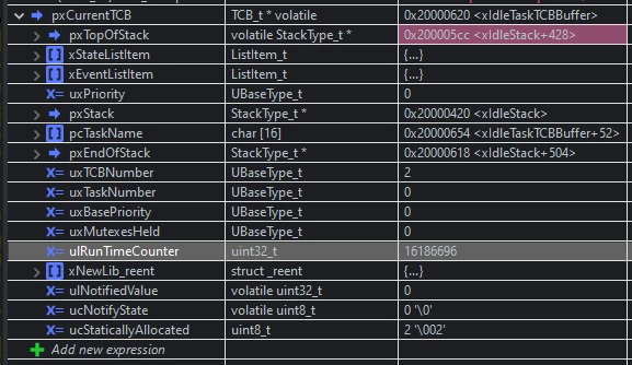

STM32CubeIDE don't show Run Time (%) on debugging freeRTOS
0693W00000JPPPRQA5.pngAt same time all structure fields are exists.

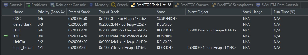

0693W00000JPPPMQA5.pngWhat I do wrong?

Follow the STM32CubeIDE User Manual UM2609 Chapter 6.2
hth

February 11, 2022
Thx. This does helped
