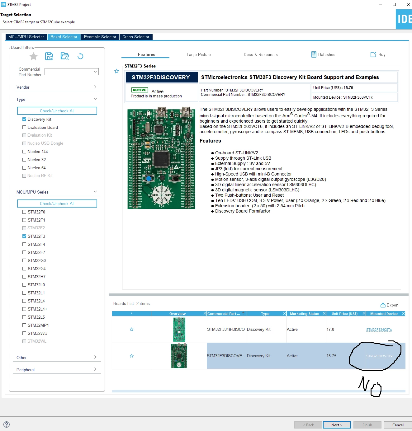

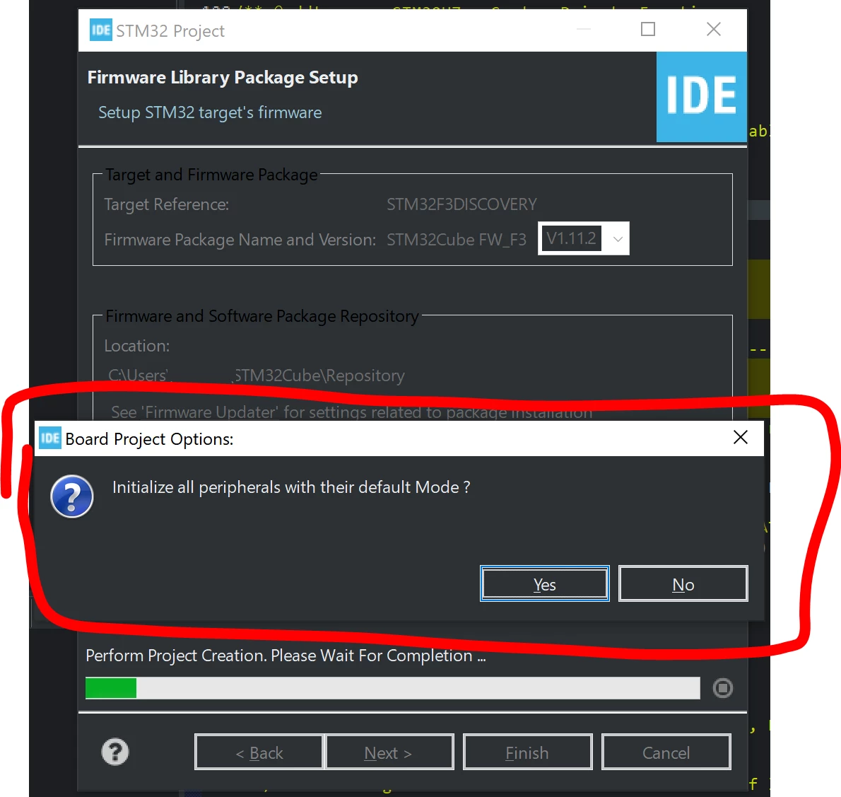

I have this painfull problem:
When I want to create a new project, after choosing the board and the name of the Project clicking on "Finish"doesn't show the window wher can choose to load the default mode of the peripherals, but instead load immediatly the blank configuration.

> In the next window sort by “discovery�? and “F3�? and select STM32F303VCTx and then the first option, package LQ, and then click on “Next�?.
Sure sounds like you're choosing a chip and not a board. If you select a board, you don't have an option to select the package type.
Make sure you're on the "Board Selector" tab, which you don't mention at all in your steps.
Works for me.

I’m following this steps:
  1. Open CubeIDE and click on “Create a new STM32 Project.
  2. In the next window sort by “discovery�? and “F3�? and select STM32F303VCTx and then the first option, package LQ, and then click on “Next�?.
  3. Chose a project name and then “Finish�?
  4. At this point, no other windows comes out and a ioc file open up with a black configuration.
Please help me out

You are absolutelly right, at this point just click on "Next" instead of "STM32F303VCTx" in blue...0693W00000BbhnTQAR.png
Was so simple... thanks everybody!
